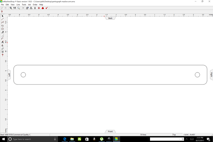

took 1 minute and drew this up in emachineshop.com
how can I share this file with the community?
it’s basically 1"x10" bar of steel with 1/4" holes spaced 1/2" from ends
