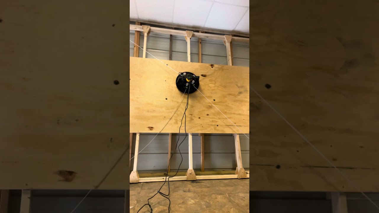

I received my M4 a couple weeks back and finally set aside a few days to put it together. I finally got it put together but am unable to calibrate it.
I followed the wooden frame instructions and from center-of-bolt to center-of-bolt, the dimensions are: 116 3/8" x 95 7/8". Diagonals are: 150 5/8" & 150 3/8"
I am using the recommended DeWalt DWP611
According to the logs, I am on version 0.72.
When trying to calibrate the M4, it attempts to go through the calibration pattern and tightens the belts in each position, but when doing so, it moves sideways a significant amount. Additionally, it seems like some of the bottom belts, more specifically the bottom right, spools up a lot but isn’t fed out. I’m unable to achieve a fitness of over about .08, and usually ends up around 0.65. The frame is solid, anchored to the wall studs with about an 8 degree or so angle.
I recorded a video of this attempted calibration and will upload it when I’m home with a better connection. Here are the logs from the recorded calibration run:

If you extend the belts fully by pressing Extend All and then retract them fully what do you see printed out in the console?
Another thing to check is that you have the horizontal setting correct, as having that set wrong that can cause some strange behavior like that.

Here is the recording of the failed calibration

These all look pretty good so that’s a point against it being an magnet slipping issue
https://m4cal.etskinner.com/
Plugging that data into here it does look like there is something funky going on with the data:
And looking at the video there is for sure something funky going on there.
In the settings is it possible that it’s set up for horizontal calibration instead of vertical?
It is set up for horizontal. I interpreted that as the orientation of the board (as in, the frame is 10 foot wide, 8 feet tall in horizontal, flipped in vertical). But rather that setting refers to the actual laying down flat vs hung on a wall orientation?
Yup! That should fix it!
horizontal is “frame is flat on the floor or close to it”
vertical is “frame is leaning against a wall/legs”
we really need to change the UI to better describe this.
Yup. This was my issue all along. Ran it one time with the proper orientation, and it calibrated just as it should. I assumed I missed something about this setting during the guide, but looking back on it, I agree with you. Maybe I’ll make a post to that user guide feedback post suggesting this clarification.
