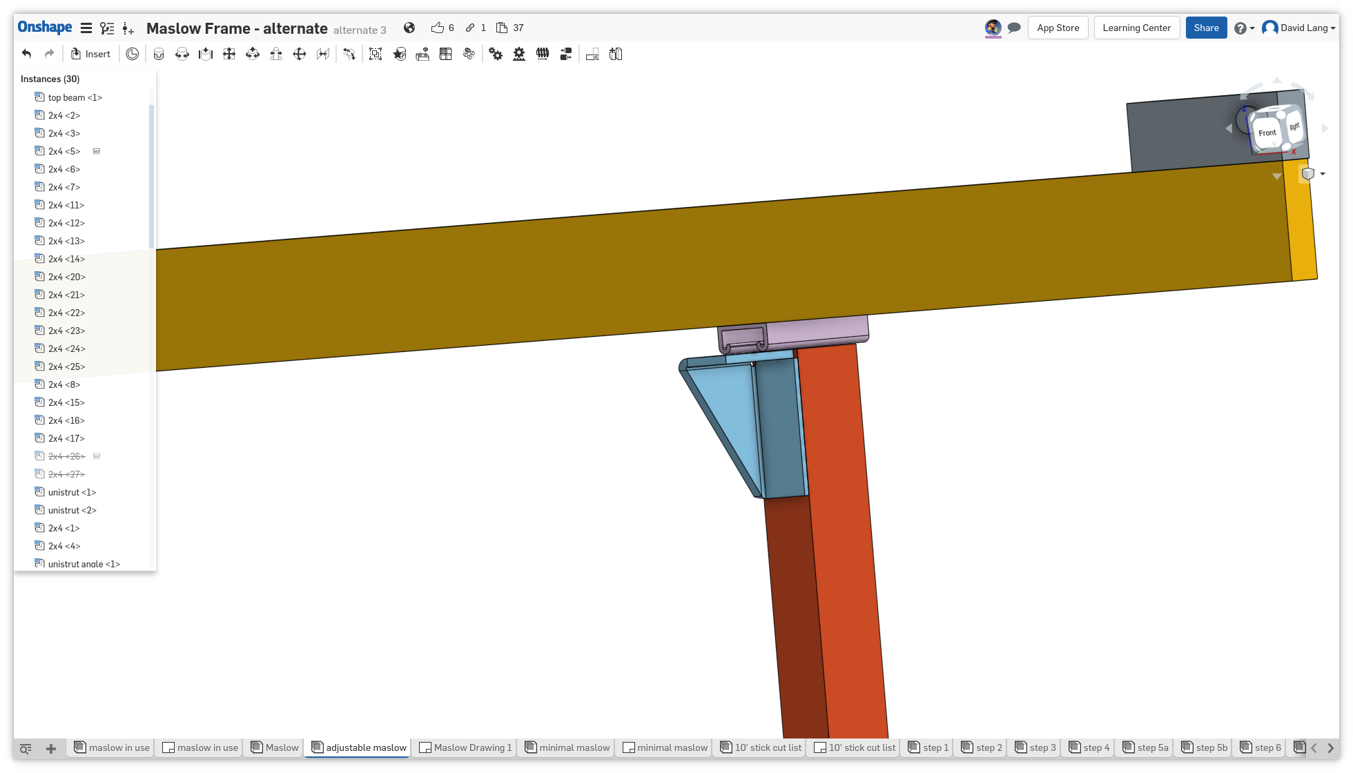

I think this approach satisfies your needs for the frame
for attaching the top beam and adjusting it easily, these pictures from the 1000 post ‘new stock frame’ thread
This is rotated wierd (the red parts are the legs, the yellow part is the top beam, shown as a 2x4, but could easily be unistrut) The purple part is a piece of unistrut that can be moved by loosening the bolts to the angle bracket and then slid)
another view with a different bracket
with this sort of approach to make the top beam adjustable along the Z axis (and with a solid angle bracket to make sure it’s square to the legs), you can make it so that it’s very quick to adjust.
adjust the chain mounts to the sled so that when hanging from the chain it hangs straight or just slightly fop tipped towards the workpiece
mount a solid block to the leg (one on each side)
adjust the beam in or out until the chains are parallel to the frame with no workpiece (and no extra wasteboard)
mount a block to the movable unistrut that is now in solid contact with the fixed block
now you can quickly adjust the top beam position to the perfect position by taking a piece of material that matches your workpiece, and a piece of material that matches any wasteboard you are adding and pinching them between these two blocks. This will move the top beam out just the perfect amount to keep the chains parallel when cutting with that material.
For the sled attachment, the top mount kit has a pin that you put through the end of the chain into the metal arm (just a smidge smaller than the pins that ship with the stock kit)
it’s best to do this when you don’t have to support the weight of the sled, so you should have a hook/pin/bolt on the top beam at the center, and a hole/hook on the sled that lets you hang the sled from the center of the top beam to support it and keep it out of the way.
