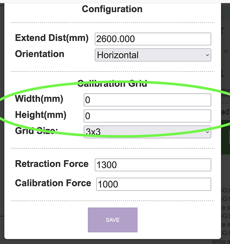

Re: “If you set your grid size to 0x0mm”
That grid size doesn’t appear as a choice in the dropdown on the Configuration screen.
Is it meant to be there?
Dave
It’s this part that we need to set to 0mmx0mm
The number of grid points to use will then be calculated automatically too.
Hopefully in the next version we can eliminate that setting entirely which will make things easier
