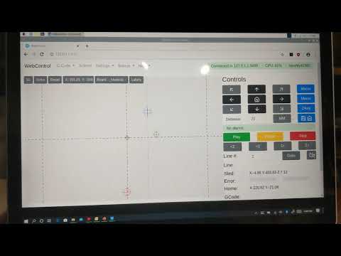

You had it right. The webpage displays in the correct orientation in all respects escept the model and X movement is upside down. Move the cursor down and the crosshair goes up. Move the sled down, the indicator on the board goes up. The left and the right are fine which is really wierd. I’m trying to upload a video to YT right now.

Here is the video. I am remoted into the pi and running webcontrol in chromium on the pi.
I’m confused. I misunderstood that your sled was actually moving in the wrong direction, but after watching the video, the mouse is moving the wrong direction?
The mouse is the blue reticle. The sled is located at the red reticle and the expected endpoint is the black one and the home is the green one. when you touch upward, the blue moves down? My friend google pointed me here:

Kinda, if you look at the video, the very small black dot acurately reflects the movements I am doing with my mouse. The blue is webcontrols representation of what my mouse is doing, which is vertically opposite. Left and right are correct, the webcontrol display has the vertical flipped. It is solely a display problem. The actual function of the sled and z axis does not seem to be affected by the problem. The extra puzzling thing is it only shows up in webcontrol and only on the board part of the display.
You found something. That’s a new one: just the vertical axis of the mouse on the display and only on the board view area is backwards. That to me begs the question: is the scroll lock for your keyboard on? And why would that matter? New laptop scroll features move opposite of old school ones, so maybe it has to do with that, but why only the board area and not the rest? Chromium is on a small display so it is in the mobile mode. I guess the workaround is to move opposite vertically. The good news is that it works. When my touch screen was working, I never saw this in chromium. I had chromium set to automatically load the page on startup. I had the screen in portrait mode though and that had its own set of problems.

I see this is an old post but I had the same problem and thought this would be a good place to post a possible resolution. I use a RPI with Chromium to run WebControl. When I turned off “Hardware Acceleration”, relaunched and the work area was right side up. This blog provides a better explanation. https://www.howtogeek.com/412738/how-to-turn-hardware-acceleration-on-and-off-in-chrome/#:~:text=In%20the%20Settings%20tab%2C%20scroll,anything%20you’re%20working%20on.
Thank you @cwelch that worked perfectly! I had been running on Ground Control from an old laptop with no issues. I bought the RPI with Web Control loaded from MetalMaslow and when I set it up, everything functioned like normal but when I loaded gcode it would display the cut shape upside down. It still cut correctly, so I just used it and deal with it. Saw this thread today and tried your fix, my cut shapes are right side up now. Muchas Gracias!
