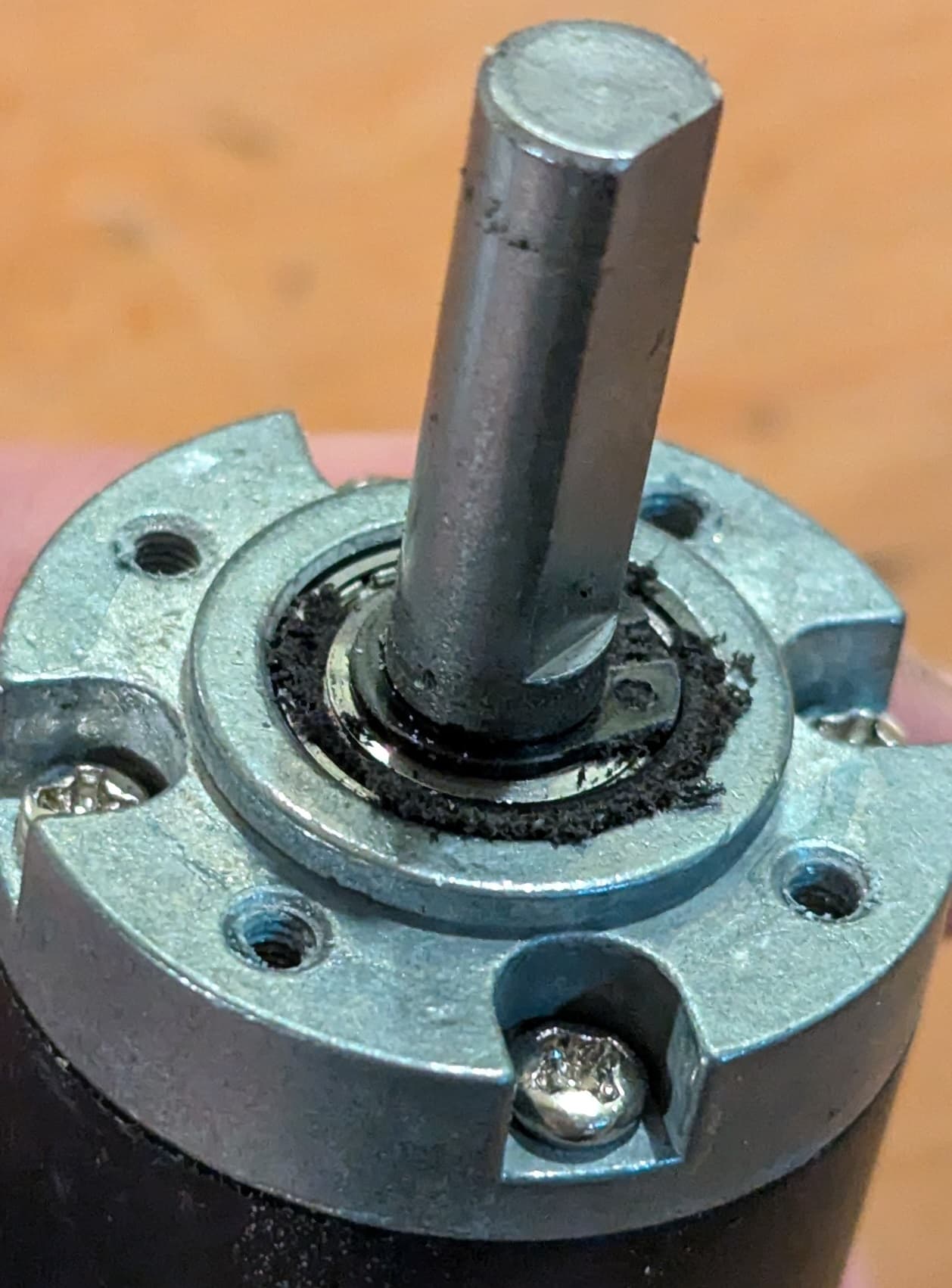

I think the arm frame needs a shallow pocket around the motor/gearbox shaft (on the outside face). I opened-up all my arms this weekend (anticipating arrival of the new JST XH encoder boards/controller - also trying to understand more about non-uniform current demand across the arms) and discovered that a ring of the plastic had been worn away. The plastic debris has been trapped around the shaft and ground to a fine dust/paste consistency - no sign of harm, but it can’t be good to have that circulating around the gearbox’s output bearing.
It looks like there’s a retaining ring on the shaft that extends slightly beyond the face of the gearbox - I suspect that’s what’s causing the wear.
Here’s a new arm frame for reference
Here’s a worn arm frame
And here’s the debris
