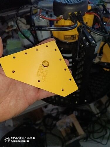

Also throwing in some pictures of the rock solid corners my friend made for me.
