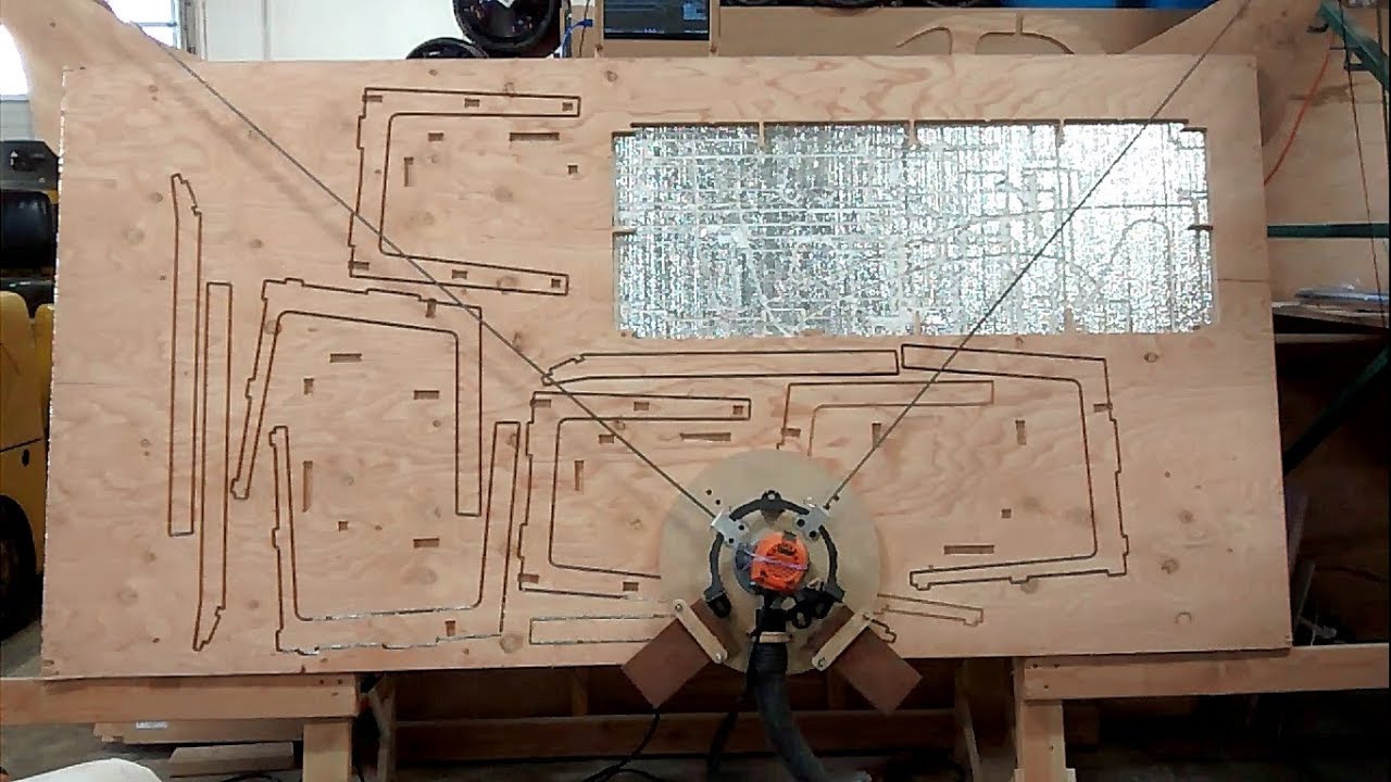

Yes! The plan is to have the smaller size made in bulk and then have some larger ones made locally. What is the smallest ring which your router could fit inside? (smaller is better because it reduces lever action making it rotate more smoothly)
We won’t be able to get them until the parts come with the next batch so it won’t be until later in February. I’ll be sure to give everyone a heads up in the forums before we post them, so yes but no need to check back regularly or anything.
Here’s an old one from one of the early prototypes:
I will try to get some more video
We’ll sell them at about what the parts cost us and I’m pretty confident that will be right around the $40 price tag of the linkage kits.
I’m not sure that there will be any significant improvement over a perfectly installed linkage kit. There are two factors in installing a linkage kit correctly. First the holes have to be spaced properly and I’m not sure what effect say a 1mm error in the hole positioning would have. Second, the linkage needs risers to offset the height to balance the center of gravity. The risers need to be the right height and have very little play in them which can be tough to source.
The big advantage of the ring in my mind is that it doesn’t leave a lot of room for installation issues. The shape is defined, and it’s very easy to adjust the vertical offset by moving it up and down on the brackets.
