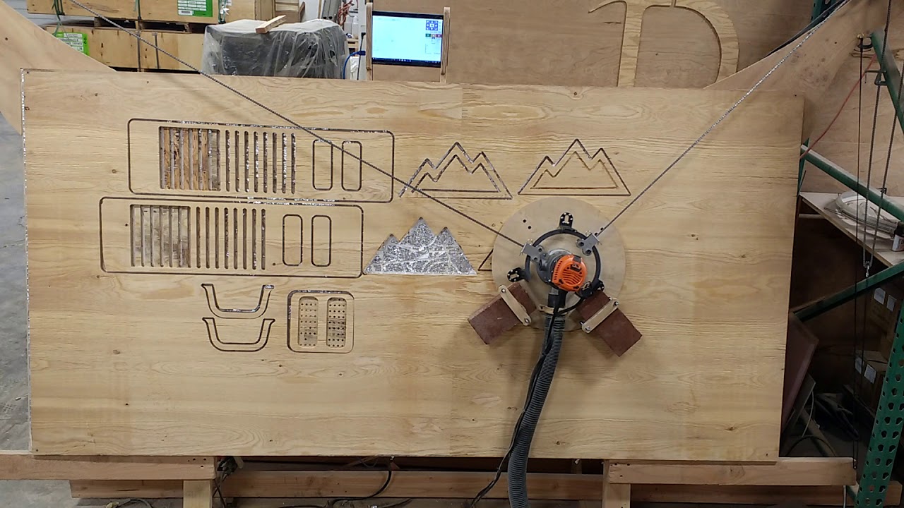

What is the plan for the new ring kits for existing users?
Oww my eyes! Got anything a tad slower? I’m interested in seeing how smooth the movement around the ring is. :slight_smile:
Yes, I will film something not sped up :grin:
Now all you need to do is to incorporate a Z-Axis motor for the riser that is parallel’ed off the router Z-Axis motor so it moves the riser up and down proportionally with the router!

Thanks for that David. I am planning on using layers of plywood for the risers as my first option to get my unit close.
Kind Regards Stuart
The riser height should only consider the center of gravity in the Z axis for
the sled.
To make the chains parallel to the workpiece should involve moving the motors in
and out (a problem for the current default design, pretty trivial for a
top-mount design)

Were you referring to the current Default design as relating to the frame construction?
Yes, the frame design with the nice, pretty wings attached to a piece of
plywood.
This then puts the motors on smaller pieces of plywood sticking out from the
wings.
The result is a large distance from where the chain is and where the strength of
the wood is (in all dimensions).
Where does the current COG lie in the Z Plane?
with a ridgid router, somewhere around 3-4" up from the top of the sled.

I was thinking of trying to make one out of plywood, easiest to make, but thought that it would probably not last too long.
Well done everyone, the new sled ring addition to the kit brings it so much closer to the gantry flat bed cnc’s
i dont know if it been said or not but theres at least 5 people that i would like to have this ring before i receive my maslow this feb. just for pure insight on the construction and what not to do or to due plus plenty more things that they c .so i will pay for 1 of the five to get it if this is pausiable
I think Bar’s ring is going to be great but in the meantime I made a ring out of 1/8" aluminum sheet using a trim router and piece of wood as a circle cutter. I used some bar stock to make the bearing chain arms.

Here’s a not light speed video of going edge to edge to get maximum ring tilt
