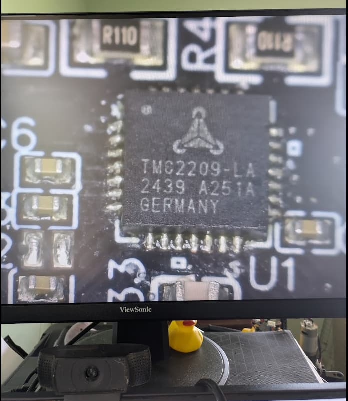

So i reflowed the solder on those two IC for the z axis, quite roughly tbh, with a soldering iron and so far it seems to have worked, both z axis motors moving up and down no dramas with manual jog

It sounds to me like this is unfortunately a soldering issue not software so the only solution is to reflow the chip or get a new board. I’m happy to send anyone who needs one a new one ASAP.
I’m talking with the factory to figure out what went wrong and how these weren’t caught in testing.

Can I get a code too please? After assembling my unit and upgrading it from 0.87 to 1.07 I started playing with extending and retracting the belts and after all that seemed to work I tried to move the Z-axis but nothing happened. After finding this tread last night, this morning I took the PCB to my ‘lab’ and after removing the heat sinks and cleaning the dried compound from the two drivers you indicated, I was able to reflow them. And now the Z-axis steppers work as they should. Yeah!
I was not able to reattach the heat sinks because I don’t have a compound that dries like an adhesive, but I figure those drivers don’t get all that hot because of their low duty cycle.
That said, I would appreciate a proper unit in case my handwork proves less than robust.

I also seem to have one port that does not work on my board. After “no z-axis movement at all” I updated maslow.yaml to the latest version and it worked! That was excellent, a moment of :slight_smile: ! I switched off my Maslow and when I switched it back on the next day to start initial procedures, 1 z-axis did not work! Ai ai ai. I read a bit on the forum about it and I switched the cables and sure enough, the other Z-axis did not move. Then I left my Maslow on for a long while, long enough for it to heat up and … yes, both motors worked! It seems to be a common problem. I read about reflowing but I have no experience with that. Is there anything else I can do? I have a good soldering iron and experience soldering (simple) electronics. Or maybe someone can tip me on how to reflow the one z-axis controller-chip?
Oh, I see there’s a heatsink on top of the two chips.
Any advice is appreciated!
Kind regards,
Huib.
Yeah, the solder connection isn’t reliable so sometimes it will work and then sometimes it won’t :confused:
The most solid way to fix it is for me to send you a new board. I’ll DM you a code right now.
