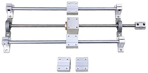

Z axis upgrade and sled
Z AXIS UPGRADE AND SLED
Dust port. AEG part.
AUTO Z cable clamps.
Amazon 3d z axis:
AEG clamp system

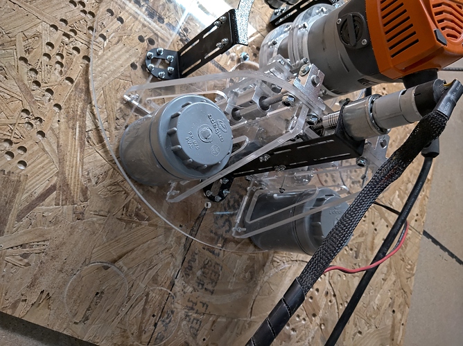

Nice work. It looks like it was carved out of lexan/arcylic/plexiglass? The weight containers are interesting. Nice and compact.
Very cool. Don’t be so coy, tell us all about it. :grinning:
Love the clear sled material. I have to admit that when I first saw the picture below, I thought you had built a monster sled out of chipboard! :laughing:
SLED AND PARTS
PMMA 8mm Poly(methyl methacrylate)
WEIGHTS exterior
PVC (Polyvinyl chloride) plumber parts
WEIGHTS interior
Shot (pellet) for scuba diving
Thank you for the details. How much weight do you have on the sled?
Very interested in your design. I have a lot of 1/4" smoked Lexan that I’d love to use.
Old Sled 13 kg
New Sled 13 kg

looks beautiful, just worred that plastic will become foggy and scratched up. a round UHMW shim underneath the sled might help prevent that.
