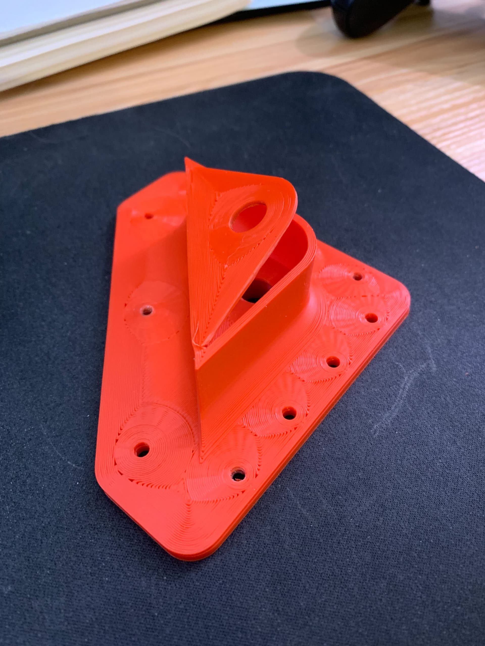

I had one of the 3d corner mount prints from the non-shop pop its top so I decided
to reinforce them a bit by doubling the thickness on the top face, adding some rounded bevels to the inner pocket in hopes of giving it more holding power from the walls to the lid and added some ribbing wrapping from the side walls across the top surface. I did have to sand the hole opening just a bit to get the pin to slide smoothly in and out but it didn’t take much.
I also recommend printing with 100% infill, so they are solid and dont have “support” inside.
Firstly, thank you for sharing your design/remix.
Are you printing these with, or without support structures for the overhangs?
EDIT: Nevermind, looks like I should enable support structures…
Yes with support.
CF reinforced PLA has a tendency to be more brittle than regular PLA, which is what PLA can be known for.
But otherwise, CF whatever.
