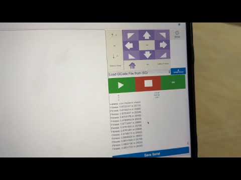

Here’s another failed attempt at calibration because I’m a glutton for punishment.
This one looked like it was going to succeed until the Maslow just turned itself off midway through the process.
Sorry about the aspect ratio - I turned the phone to horizontal part way through so I had to cut the clip to rotate it.
Log is here:
Maslow-serial-14.log (22.5 KB)
At the beginning of the log, I was raising my Z to remove the bit I had inserted yesterday.
Once the bit was removed, I retracted all and extended all belts and attached them to the frame.
My config settings were:
I then pressed Calibrate.
The machine attempted to Calibrate, running through waypoints 1-5.
It tried Calibrating for a few seconds, then spit out some calibration values then it looks like it tried calibrating again on its own
It measured more waypoints (way more than the 3x3 would require) and started running calibration again.
That lasted for 10 minutes, then it spit out calibration values, said it was measuring yet another waypoint (15) and promptly turned itself off.
WTF?!
