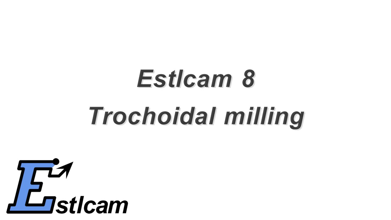

Havent tested on M4 yet but when cutting arcrylic or poly I find its best to use trochoidial toolpaths–otherwise plastic melts.
Estlecam makes it easy
Trochoidal milling is a machining strategy that involves a peeling motion to create circular tool paths, allowing for efficient and effective material removal, especially in slotting or pocketing operations. This method is beneficial because it reduces heat accumulation, minimizes tool wear, and allows for higher material removal rates with less stress on the tool and machine. Trochoidal milling is especially useful for machining hard materials and deep cuts, as it ensures consistent chip thickness and improved coolant penetration.
