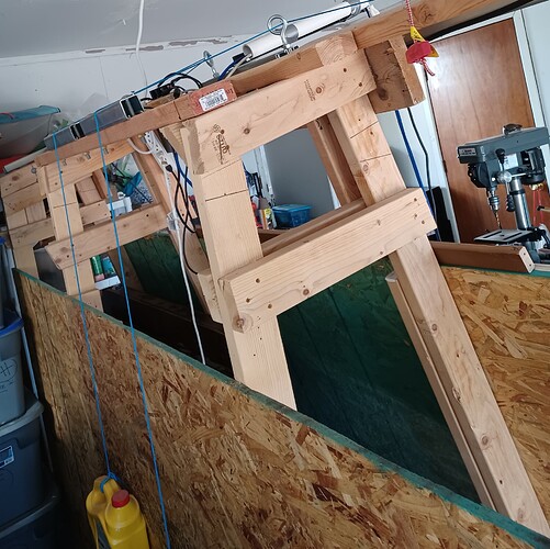

Still building a box for my shield/controller, and working on some cable management, but everything seems to work great. Big thanks to everyone here who helped me out!
Some test design stuff I did after calibration.
Whats this blue thing you use to fix the position of the top bar?
Hi @arnd ,It’s a Nylon cone Nut, thats made to work on superstrut. The blue plastic holds the nut in place on the open strut end so you can get a bolt started into it. As you probably saw a few folks here built there entire frame out of SuperStrut or UniStrut.
I just used it for my top beam, since the heat and humidity where I live loves to twist up framing lumber.
