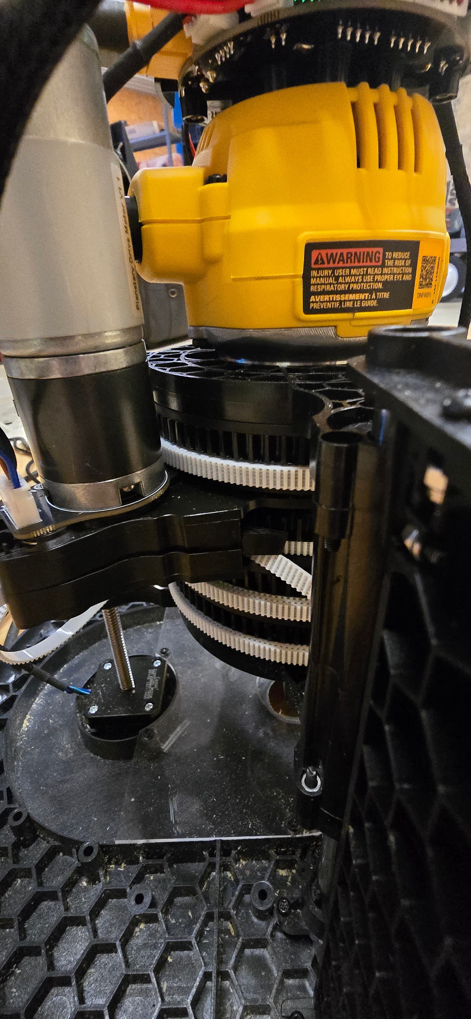

Went to calibrate and the belt on one of the axis did this. Looks like there was slack that it ate and now it’s completely jammed. Really hoping I don’t have to completely disassemble the thing to get in there.
I’ve tried to remove the motor, but removing the screws on the underside didn’t help.

parts are available, with the 4.1 update there is an updated plastic belt guard
to help keep the belt from getting in the gears. if you have a 3d printer you
can print one yourself.
I haven’t had problems like this, but many others have (which is why the belt
guard got an update after the initial shipment)
Yeah, those screws hold on to the belt guard, not the motor.
So unfortunately, you are going to have to pull it apart.

Thanks md8n. I realized that was the case after a while. Yeeeesh. Horrible process.
If you leave some of the belt loose, about one or two full turns of the spool it usually makes reassembly a lot easier.
You’ll always be doing a retract all to start, so excess belt will always get sorted out.
I have been in this situation and was able to sort without disassembly. Something that looks like a dental tool can help fish the belts out. The main issue is you have various layers of belts overlapping. The key is to figure out which layer you are on and sort from there.

So much for the new belt guard preventing this… My belt is inside the inset on the guard…ugh
Yeah, they aren’t a foolproof solution, but they do help quite a bit
