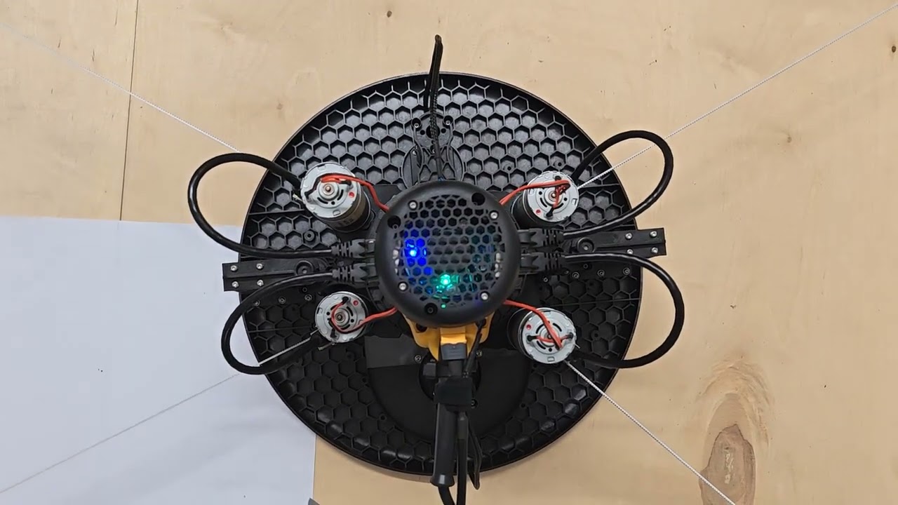

I now tried to make a dry run of the maslow logo. That worked first like a charm but then stopped suddenly. I got no error message in the browser, but a red led (LED2) started blinking.
I made a video, and I will upload it and post the link here (private video).
I hope that helps. I’m tired (22 o’clock in germany).
Bye Markus
Red blinking LED

Yesterday with the interstitial firmware 0.68.1 my fit was above 1. After calibration I made a video of the dry run cutting the maslow logo. It made some weird crackling noises and shortly after the video it stopped with the red light blinking. Here is the link to the video:
