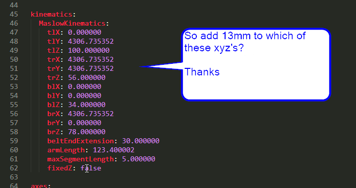

Calibration log… look normal? Last attempt took all night and never finished. Thanks for any ideas.
CLBM:[{bl:3026.88, br:3021.21, tr:3077.07, tl:3060.21},{bl:3128.42, br:2932.01, tr:2978.06, tl:3149.27},{bl:3232.73, br:3021.03, tr:2869.75, tl:3069.88},{bl:3127.59, br:3124.11, tr:2981.28, tl:2959.85},{bl:3026.49, br:3227.11, tr:3089.49, tl:2852.77},{bl:2915.74, br:3146.04, tr:3189.84, tl:2938.95},]
These seem to be poor numbers, when I run them through an alternate calibration
method, I get:
1 (B): 4867.1 ± 125.3 mm
x2 (C): 4857.3 ± 129.7 mm, y2 (C): 3657.8 ± 172.2 mm
x3 (E): -4.6 ± 7.7 mm, y3 (E): 3677.1 ± 169.8 mm
those ± error ranges look really bad.

when the fitness is this bad, it’s common that the current algorithm is never
going to converge.
when you were doing the calibration, were the belts pulling tight at each
measurement point?
are the Z offset values correct for your frame? (be default, they assume that
the anchors are at the same height as the bottom of the sled) any chance the
arms are in the wrong order?
any chance the router wasn’t all the way down at the bottom?
Thank you again for the quick reply. I already had the bit… I guess I forgot to do that part when I changed my frame size. I’ll try again with the bit out and all he way down.
I removed the bit and restarted the calibration… how do things look so far? Thank you!
not looking good
Forgot to add that my anchors are 1/2” lower than my sled bottom (1/2” spoilboard)
I would go in and increase all the Z values by 13mm

Sorry; what z values are you referring to?
in the maslow.yaml there are x y and z values for each anchor

add 13 to all 4 Z values, tlz, trz, blz, brz
in the future, you would be able to set the spoilboard to 13, but there was a
bug found that the spoilboard value isn’t included during the calibration, so
for the moment, you have to set all 4 values. (this bug will be fixed in 1.16)
