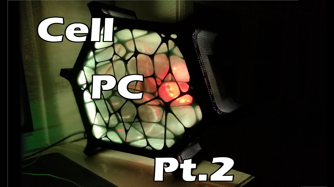

Hey all, it’s done! :smiley:
Watch the second and final part of the build here:
Featuring independent RGB lights for case and power supply, the Cell PC is ready for action.
I used epoxy resin to create a semi-transparent panel from the pattern that was cut on the Maslow in part 1: Cell PC Part 1 - YouTube
While I planned to use glow-in-the-dark pigment to cast the innermost layer, I decided against it – being able to see the shapes of the components and cables looked so much more organic to me.
The pulsating light from the power supply makes it look even more … alive, compared to running the case LEDs on their own. Honestly, this worked better than anticipated.
There was a bit of a hiccup in the casting process (the video will show you all the uncomfortable details) and it meant that I had to repeat a sizeable portion of the build – which is why it took me so long to complete.
So, apologies for that; let’s have some pictures of the final result:
Tell me what you think of it! :grin:

Regarding those pictures: the ones with the rough-looking wall in the background are 15-second exposures where I ‘hand-painted’ the light into the background. I spent hours in the darkness of my cellar shooting these, only to realize that I had done them without the power supply running… if only I had known… :smirk:
