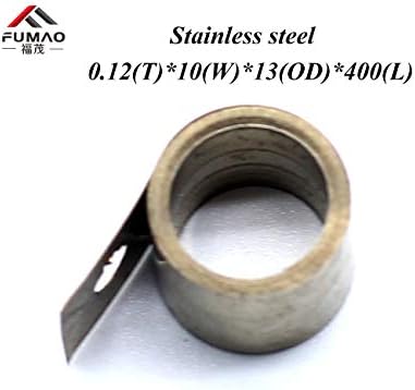

Perhaps we can find something here?
Expensive…
I’d look around here (not endorsing this particular one, just as an example):
Looking at how narrow these springs are, may need a pair.

Why going with 2 springs when you can go with only 1, thicker, stronger, longer ?
Here are the data I have no clue on what to choose from :
Spring Force : about 22 to 26N = overkill ? I took the same values as “counter-weights” which are a LOT more than a measure tape spring can deliver…or even a retractable power cord… but again I have no clues… and I hope the clever guys will help lol.
I found those ones, with so much choice I am just lost.
https://www.asraymond.com/constant-force-spring/CF0550583.
Maybe It is better to order several value to play around and check.
