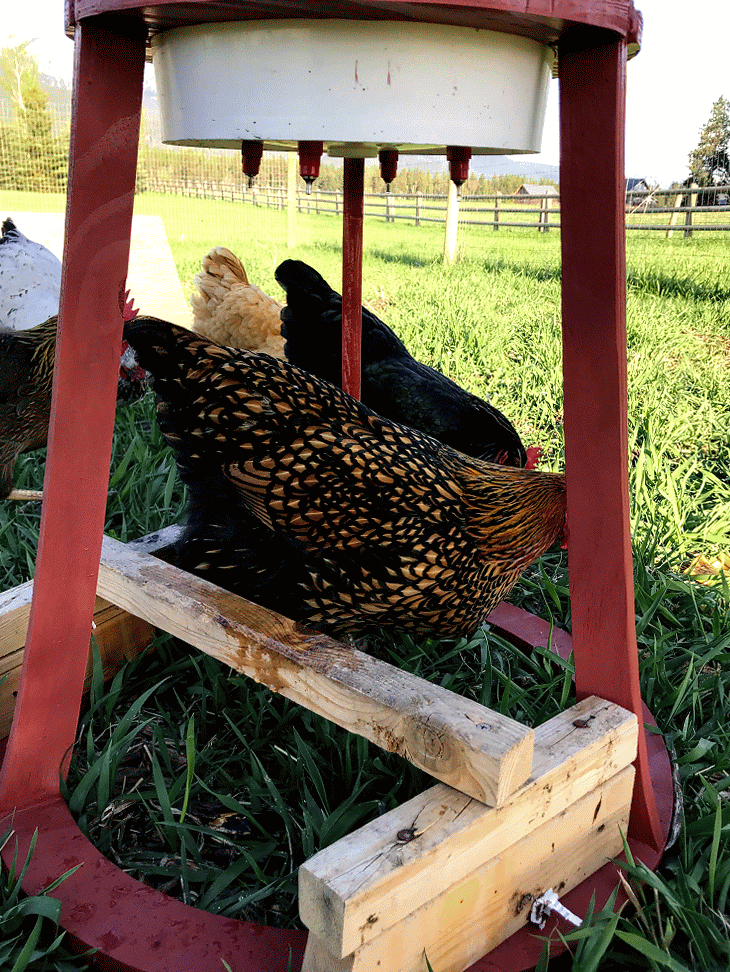

So we have 8 chickens and they needed a stand to hold their water bucket. I used this project to teach me a bit more about OnShape and to experiment with different joints (pockets in the bottom ring and interlocking in the top ring).
I probably won’t post this in the Community Garden, since this is pretty custom to my needs.
As I went about creating this, I found myself thinking that someone should make a plugin for OnShape that would break rings into interlocking segments that would allow you to make better use of material in the layout.
The girls are still learning how to use the nipples in the bottom of the bucket; I’ll post a picture of them using it when they figure it out in a day or two.
Still loving my Maslow; all this was cut on the original no-ring sled and original frame. Next project… new frame and switching to the ring!

How does the chicken get water out? Is it similar to a gerbil water bottle?
In the bottom of the bucket there are 4 nipples (like these) they peck at the little stainless steel rod and as it moves/lifts up water drips out and they drink that.

@theRatchet Show us the chickens! Did they figure it out??
Haha! I’ll try to get some pics of them tonight. I think they’ve figured it out or they are really thirsty (I’ve taken their traditional fount away). :slight_smile:
So here are my Dinos! They figured out the bucket.
