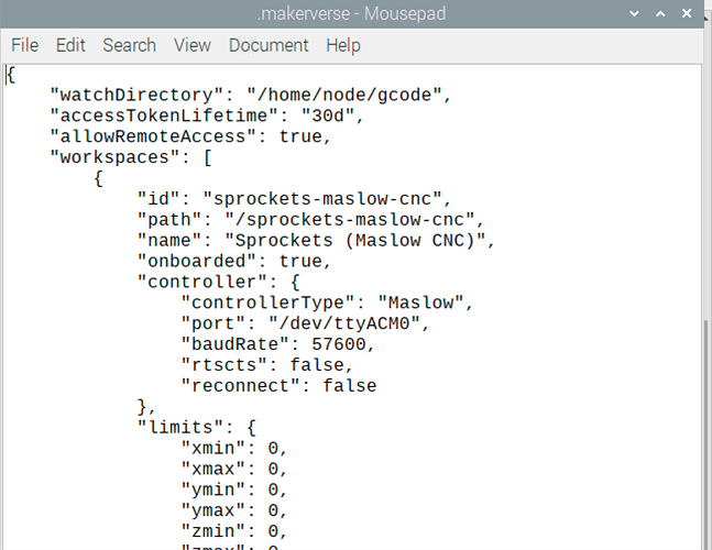

I only had time for a quick test this morning. Here are the console logs when I try to open “makerverse:8000” from my Mac.

This is very helpful. Do you have user accounts enabled in Makerverse? It’s saying you don’t have access, which sounds more like a login / session error. I haven’t really tested user accounts yet.
edit I looked at the code and there are exactly 2 reasons this error could possibly occur:
  1. allowRemoteAccess is not on
  2. User accounts are enabled, and you are not logged in
Yes, User Accounts are enabled but I am never prompted for a login. (However, I WAS prompted for a login once on the RPI when logging into makerverse:8000 locally).
Remote access is also enabled (and remember that this also fails locally on the RPI when using “localhost:8000”).
Please disable them for the moment.
Btw, I acknowledge and apologize for the confusion about user accounts. They should indeed be used as a security “best practice“. I just haven’t gotten to overhauling them yet, lots of code to modernize/fix! It’s top on my list.
Yep, this is the real problem. You are successfully logged in there, but your other devices / browser windows are not. This is causing an error instead of properly asking those devices to log in. I should have tested user accounts, but I put them off to overhaul them rather than just patch them.
Is there a chance it be a cookie issue? I’m taking a guess that would explain why the other devices don’t prompt for a login.
No. The user authentication code is buggy. I can see the bug in your logs. I know exactly what is causing it. I didn’t write the user authentication code, but I need to fix it.
I’ll let you know when it’s done.
Until then, user authentication will not work properly. Turning it off is no more dangerous than using Web Control (which never had user auth).
Confirmed - disabling the User Account then makes everything work on Mac and RPI.
Great. Again, sorry about that, this is top priority for me.
