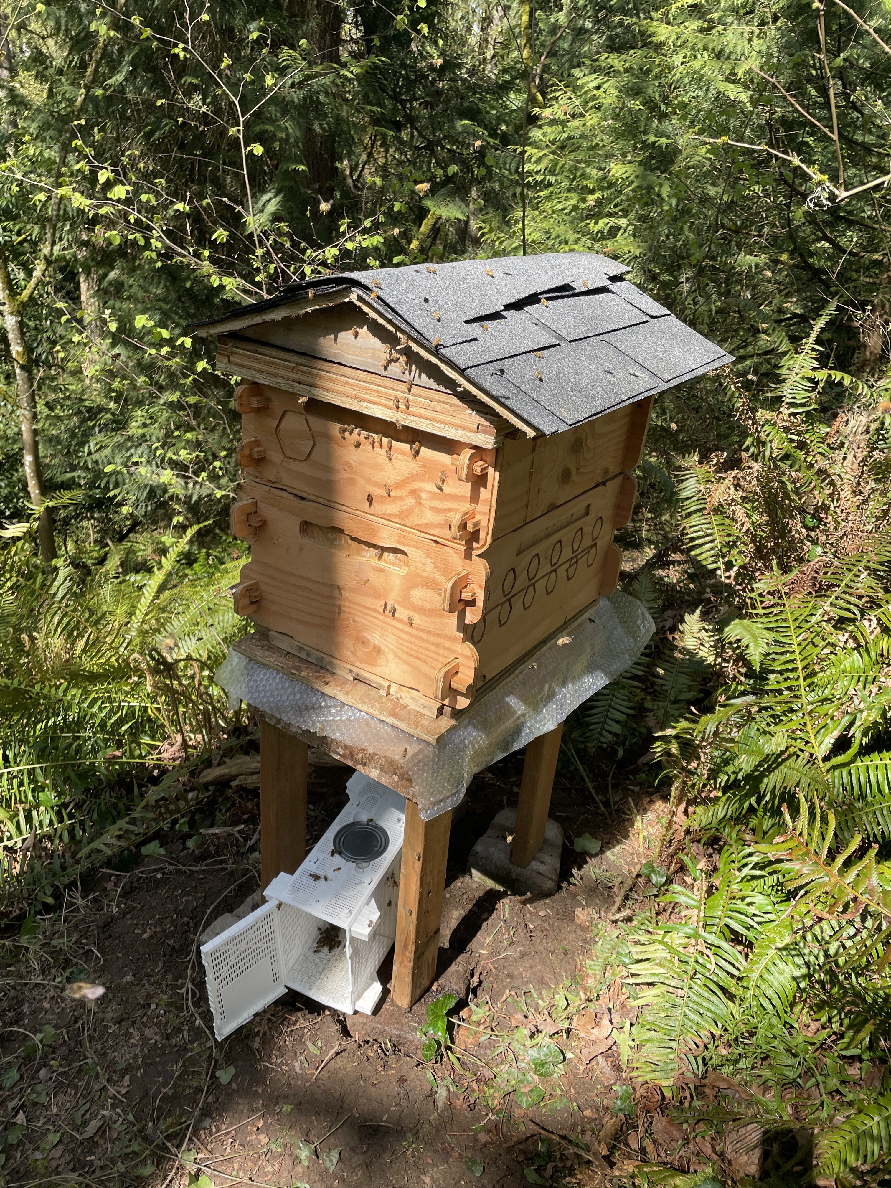

CNC Beehive Just added bees
I plan on doing this next year! Did you buy the file or make it yourself?
Any challenges in the process?
Did the bees take to it well?
Keep me updated!
I’m a novice beekeeper. They are still there after 24 hours.. There are some gaps, the bees seem to be using multiple impromptu entrances. I hear they will close those up at some point.
I made it in Onshape and exported surfaces as .dxf.
I used Adobe Illustrator to close all of the paths. Inkscape can do this as well.
Used krabzcam to make the CNC paths. KrabzCAM
Nice job. I have been trying to get the motivation to get into it too. These plans certainly will help the cause.
