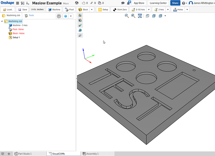

Then Load VisualCAMc app
select your part and hit add (see below)
Now this is were the fun begins…you have to visualCAMc what you want to do, but first we have to set up a few things.
Basic task that must be done before we start:
Set up machine (I used the default 3axis)
Set up Post (This is basically your CNC)
Set up Tools
Set up Stock
Set up Work Zero
Then set up actions to process

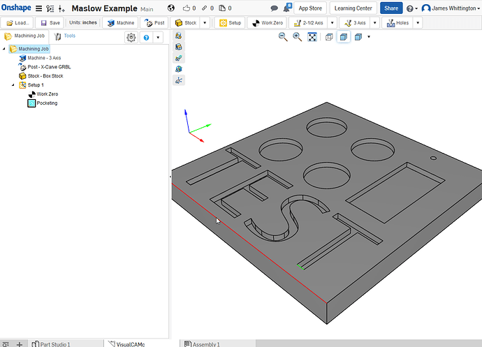

Set up the Machine (3axis)
Set up the Post (I chose X-Carve because I saw a post some place that MaslowCNC used GRBL in some form, and it worked)
You have to setup Stock, this is basically given the machine an idea what material it has to remove
From trial and error, and one obscure YouTube video I have determined that you want to check Bottom SW under the Position.
Then you want to click the Copy Model Bounding Box (not sure why, but you don’t you will be repeating the above processes because the steps after require it.
Then hit Save
Next hit select the Work Zero Icon on the task bar
On this screen under TYPE, you want to select Set to Stock Box
Under Face, Select Highest Z
Under Position Select SW
Then hit save

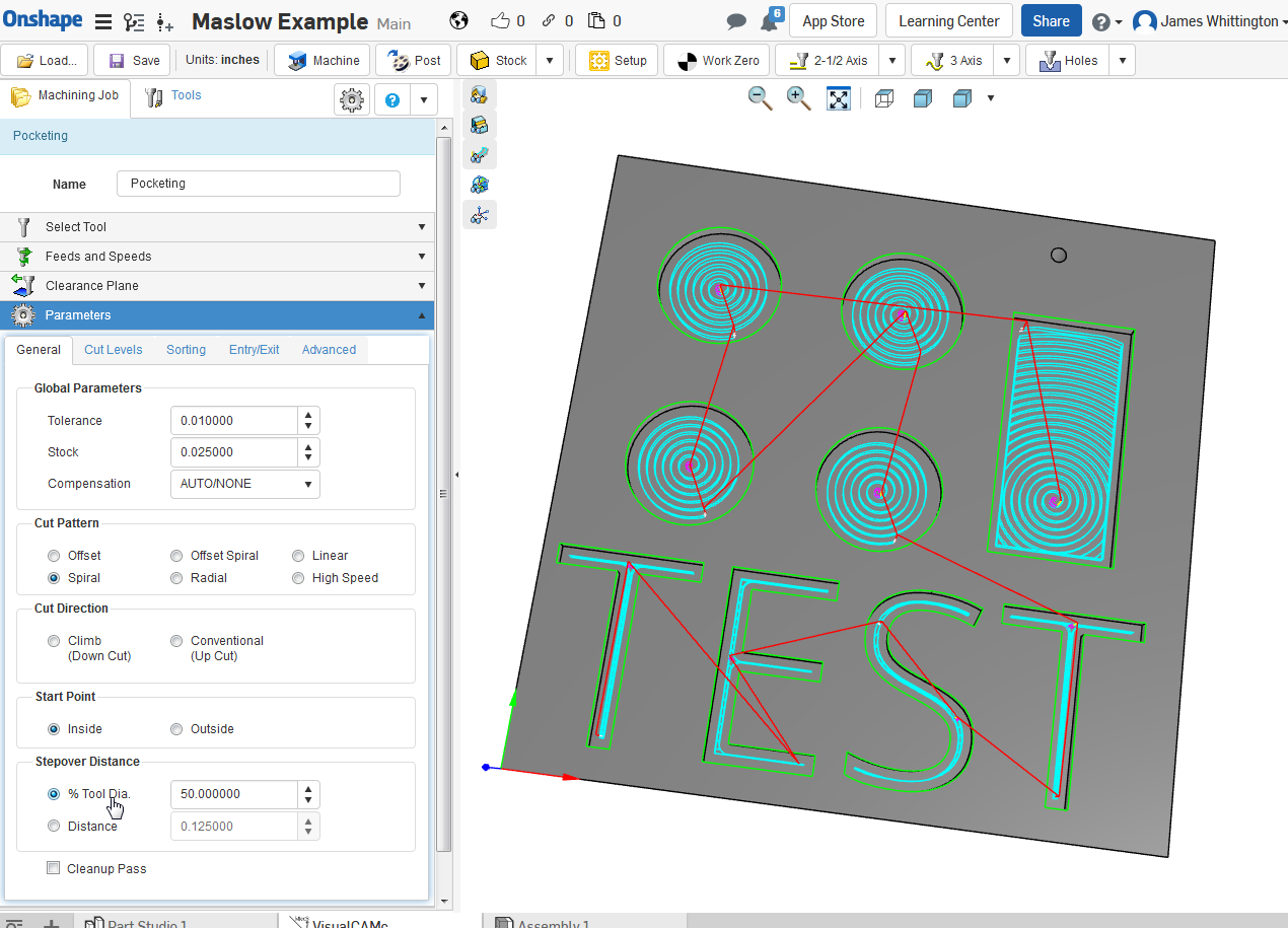

Now click the Parameters Section
This is the section that everyone is looking for!
I changed the cut patteron to Spiral, however you can run a test run and watch the end mill travel around your part to decide which you like
Since we are working on the interior part of our project, click the inside options
The next section is important…this tell the MaslowCNC how much to move over of the next cut…25% of 0.25EndMill is 0.0625inches…I have increased this to 40 and 50%…30 and 40% work better in my opinion

Now, lets see if what we did works…select Generate Toolpath
I started not to include this picture, but as you can see the toolpath doesn’t follow all the letters…basically, you have to delete this whole process, go back to OnShape, fix the item and start the steps all over
Corrected model and with new toolpath…and I increased my step over distance percent on this one
85% here
