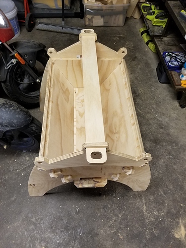

Im building the top hive for my brother. So I should have the kinks worked out soon if you need help.
Still have a few parts to cut but it’s getting there.
That looks great! Great work so far. Yes I can probably guarantee that I will need some help! Haha! Please keep me updated.
