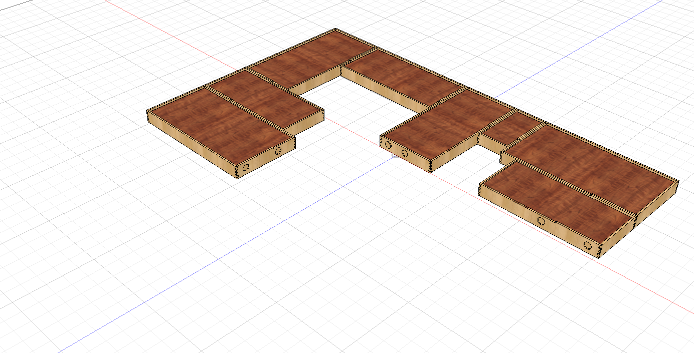

Great idea. I was planing on doing just that, but had not considered how it would help frame. Yes they will help. THANK you. Having another idea. Not sure if gopd or not. But with corners being braced. Instead of the four extender boards that need to be bolted. Take a ratchet belt around the frame and tighten. That would make frame really adjustable. Is this idea any good?
Martha
Argen
Wonder what you think. Take boards and create boarder so that corners are about 18" from corners diagonally. Place a spoilboard on boxes then use heavy duty rachet stap 2" or better around all boxes and ratchet tight. Do you think that would work?
Martha
1x4 boards should give start for boarder around 4x8 or whatever size board being used. When more mobile will work on frame again. Weak from working yesterday. This way whether 4x4 or 4x8 should work and any size between. Maybe as small as 2x2
Martha
After a little thought. Placing 1x4s that were holding the sides. Being relocated on top of box to hold spoilboard. Ratchet strap should not be needed. Even with 40lbs of torque. But thinking slots in boards for adjustment. Looks like I need to use router in some kind of jig. My lack of strength means i have trouble holding. May need router table. Or maybe I can use sled for 1x4s. Yes that should work. Tomorrow work with steel making router sled. This is coming together. Weight of boxes will keep on ground. Spoilboard with needed skirts keep things in place. I was wanting to do that anyway. Double back wood for workpiece. Thank you all.

So this is an idea for a collapsible canvas for the maslow 4, thanks to Martha for the initial idea.
The whole stack including the Maslow4 but without a spoilboard would weigh about 40kg, this is about the same as a DeWalt combi saw, which is heavy but manageable with a 2wheel kart.
The boxes are made of 12x96mm wood, and a piece of 3.6mm ply in a groove. To make sure the boxes position rightly, there are “LEGO” knobs and indents on the sides.
Maybe a large ratchet strap will be enough to pull everything together and stiff enough, maybe there need to be overcenter clamps or other ways to pull the boxes together. And maybe it will never be stiff enough :grin:
Arjen
The stacked boxes measure 509x987x437 mm
