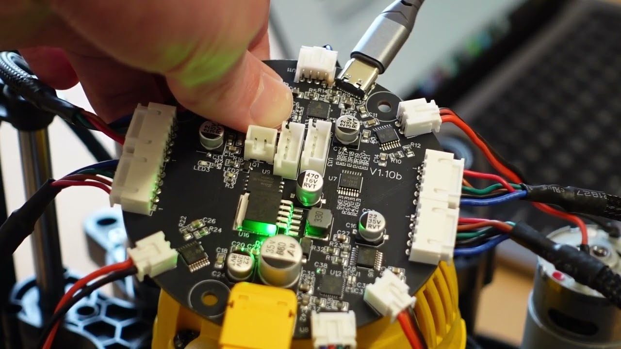

I have powered up my new maslow 4.1 board
haven’t found the “maslow” wifi
tried “findmymaslow.com” on fire fox
no luck
there is no blue led blinking out the ip address
any sugestions how i could connect it?
I see a usbc port, can that help?
This is normal if the machine isn’t connected to your home wifi.
and
This will only work once your machine is connected to your home wifi too.
Do you have a phone with wifi that you could try?
You could do the version 1.0+ update…I think that is a great place to start:
You will want to do it at some point anyway
