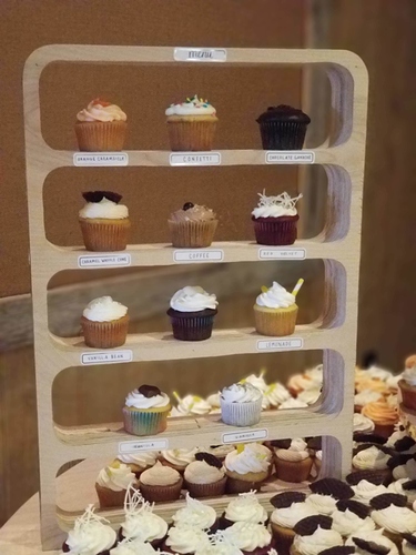

Cupcake Display Project - FINISHED!
What depth/spacing for the Kerf?

Hey @bar, here’s the “finished version with cupcakes on it.”
The whole project worked out great, and we were able to slide the flat-packed stand into the back of my Impreza and piece it together on location in about 10 minutes. I can probably post this project to the garden this week since @Sharpsburg_Woodworke and @JWoody18 think they might be able to make use of the files.
The highest platform was for the Bride and Groom’s cake.
My wife made 8/11 of the different kinds of cupcakes. She’s pretty crafty with the pastries.
We also had a menu that guests could reference while making their decisions.
There’s a few things I’d tweak, but I’m pretty happy with the design given the time constraints of the project.
Thanks for reading!

Sorry @ScrumdyBum, I somehow missed this comment until now!
The depth was about 0.625in deep with a cut every 1/4in.
The blade was like 5/16in wide I believe.
With those settings, it was still pretty rigid at that radius, so I may have cut even deeper to increase flexibility, but I was trying to be conservative.
