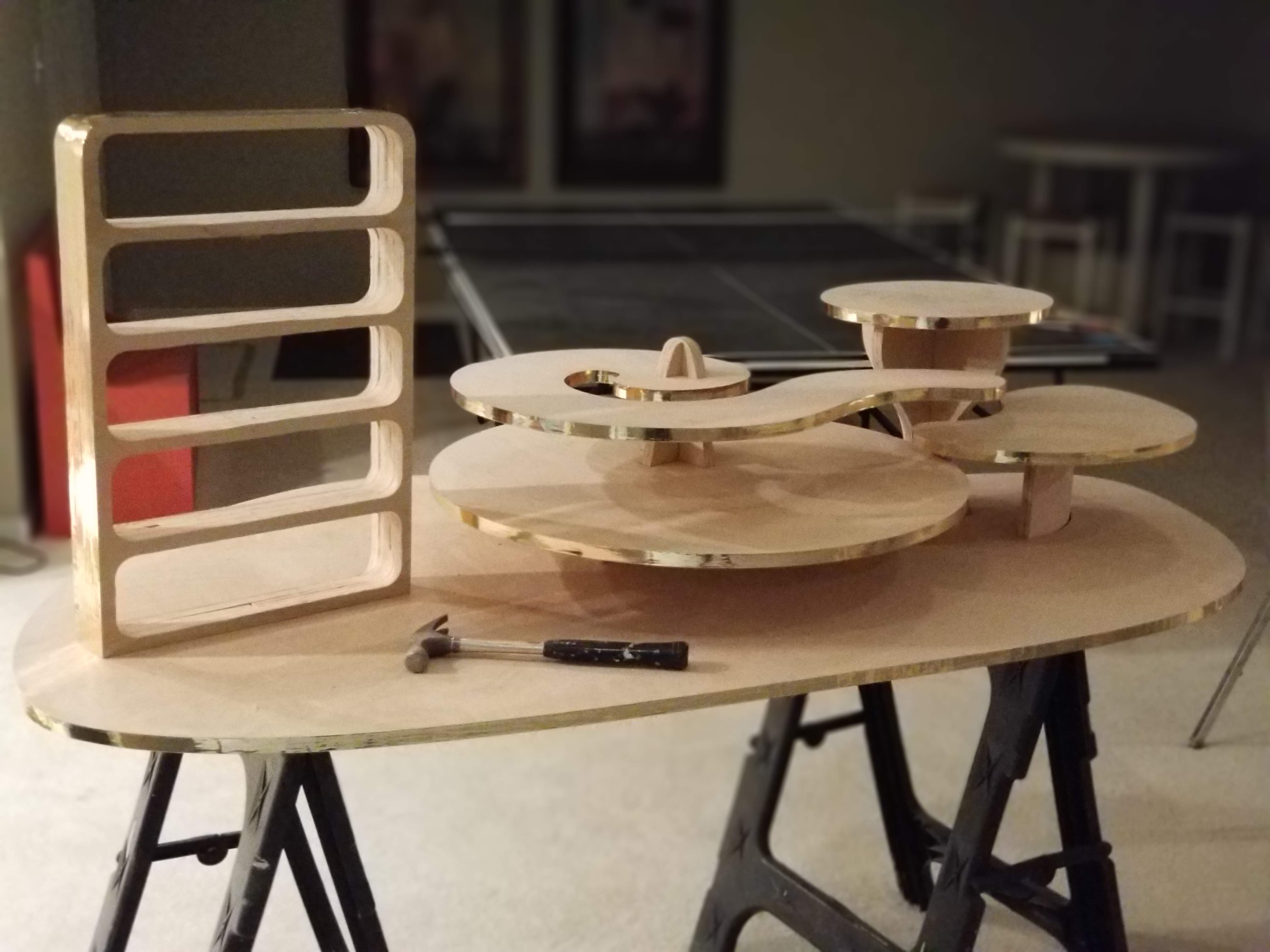

Making a cupcake display for a friend’s wedding in a few weeks, and I ended up doing a full layout in SolidWorks before moving to Fusion 360 for the CAM.
I wanted to cut as many parts on one sheet at the same time.
The cut ran for 5.1 hours straight, making it my longest cut ever on the Maslow.
Standard Speed, .15" stepdowns, Single Flute Upcut Bit.
I also cut a bit closer to the edges than usual, but no intervention was necessary.
I’ll probably post a picture of the finished product if anyone is interested. I was just excited to have the maslow operating so smoothly and predictably last night.
This is the overall design, I can post it to the Community garden if anyone would like to make one for themselves, though I kindof doubt it.
-Jacob

That is awesome. More pictures
Just wondering, the rack on the left, is it only 1 sheet thick? If so, that would mean cupcakes are quite a balanced food :slight_smile:
There’s 3 layers of plywood for that one. You can kinda see how thick it is in the last picture (render). The rack is going to be the cupcake legend with labeled slots for each kind.

Parts are all cut and dry-fitted as of last night. Just need to sand, and do a little cleanup:
(The little brace on the back of the shelves is just there to keep the parts from falling over for the picture BTW)

Got most of the gold edge banding on yesterday, should be wrapping up the project this evening, but you know how that goes…

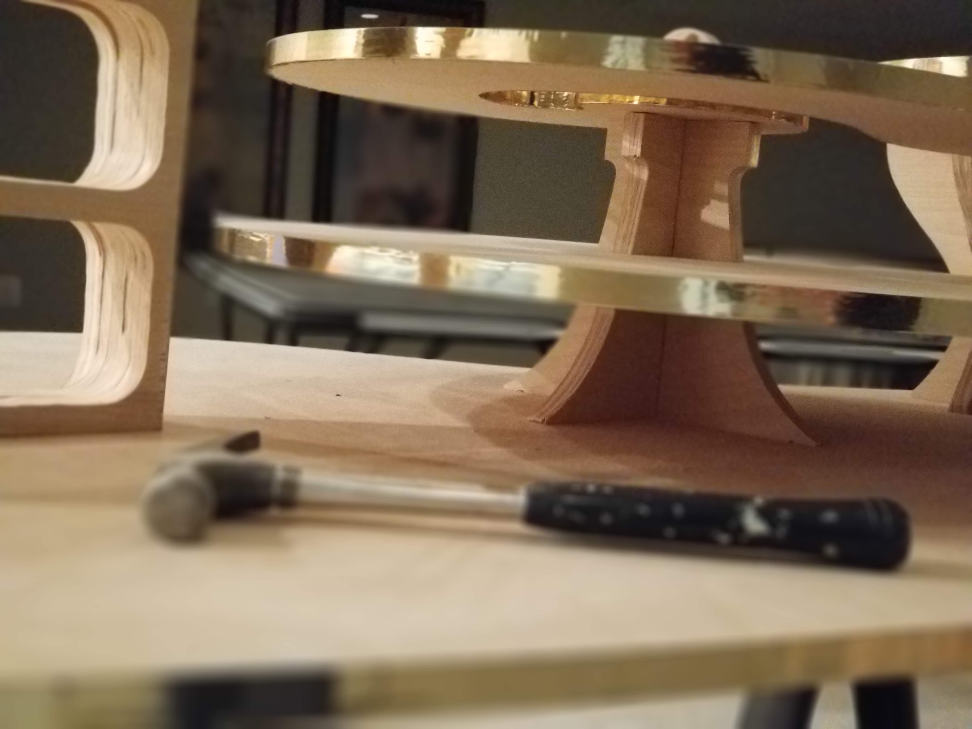

Cupcake display update:
  • I just finished the last bit of work for the display last night.
  • (I may still cut out a set of legs if I’m able to piece together enough scrap)
  • The Gold banding is just mylar tape in case anyone is wondering
    • (I’ll post a link to it when I post this project in the garden)
[Hammer for Scale]
Kerf-bent plywood for the curved bit of the support wall.
