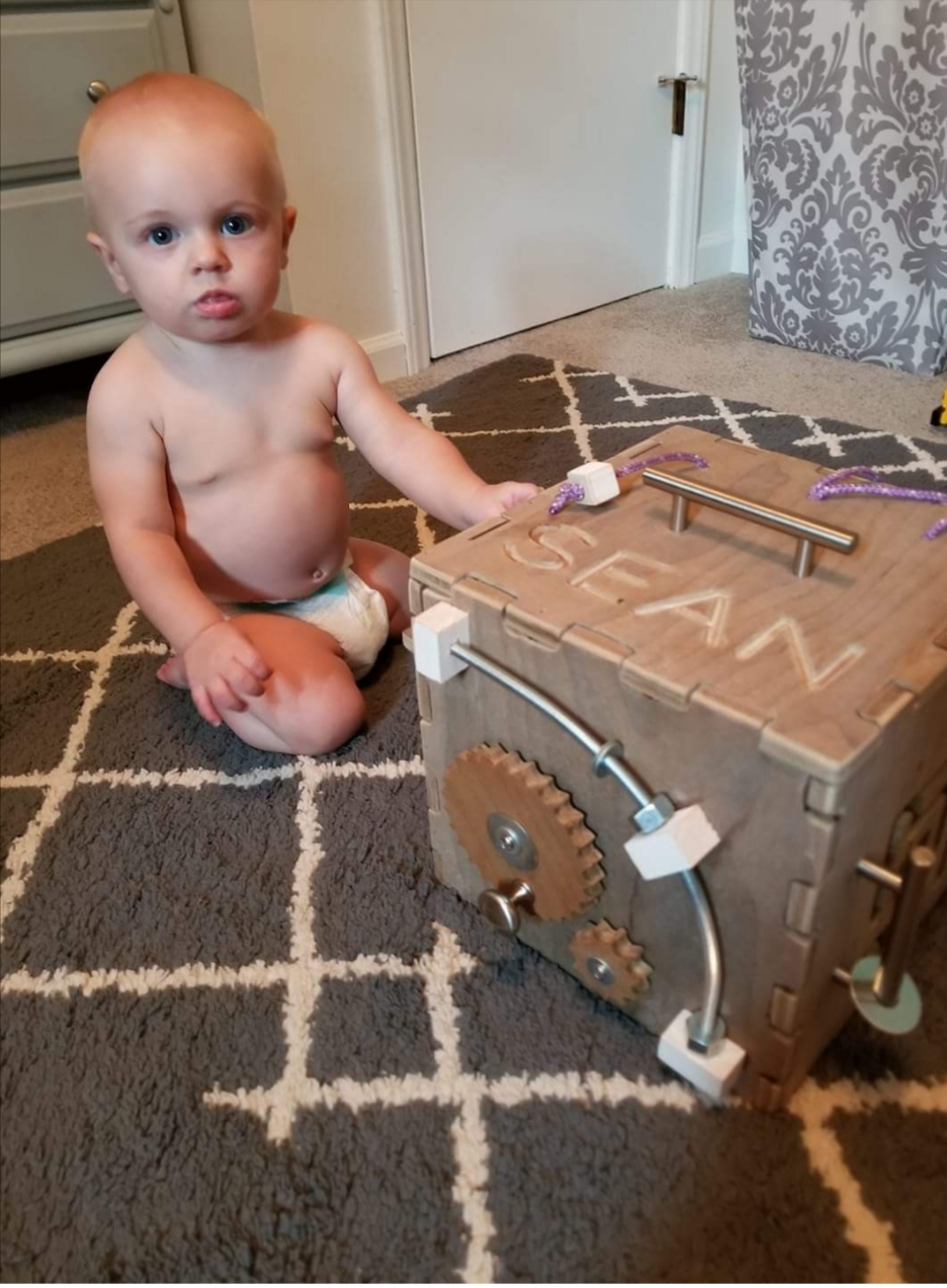

Just finished up a busy box for my son.
I thought I had my Maslow running well but this project showed me I have some accuracy issues.
Yeah, finger joints are a sure way to find out your stackup tolerances are off. I totally understand. Love this project though.
What a cutey!!! Love the project
Thanks guys. He seems to love it too! Makes me feel good to make him something, so win win I guess.
