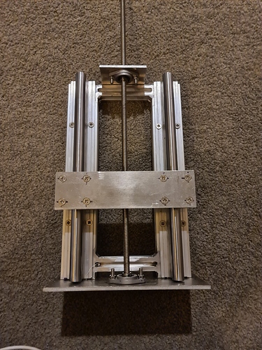

So I’ve changed my spindle to a new (better suited and lighter) makita rt0700c 65mm and have cut most of my parts for the z axis. This is what the z axis will look like. So now I can make the sled as light as possible and get it well under the 30lb mark.
Z axis progress, runs nice and smooth!

if you will be cutting hard woods or other dense materials you
will want a plate twice as big with two more linear bearings to counter act the torque.
Ok will look into getting another 2 linear bearings, these are 16mm rails and bearings, so ill definitely need another 2? Most of the time it’ll just cut plywood up to 17mm thick. Thanks
Not sure, but they are pretty cheap from China and definitely wouldn’t hurt. https://linkcnc.aliexpress.com/store/834897/search?SearchText=16mm+linear+bearings
I’ll go ahead and get 2 more bearings I can get them in nz so no worries there I’ve put most of the z axis together but I’ll simply make another bridge across the other 2 bearings and tig the 2 together down the middle here’s my progress…
