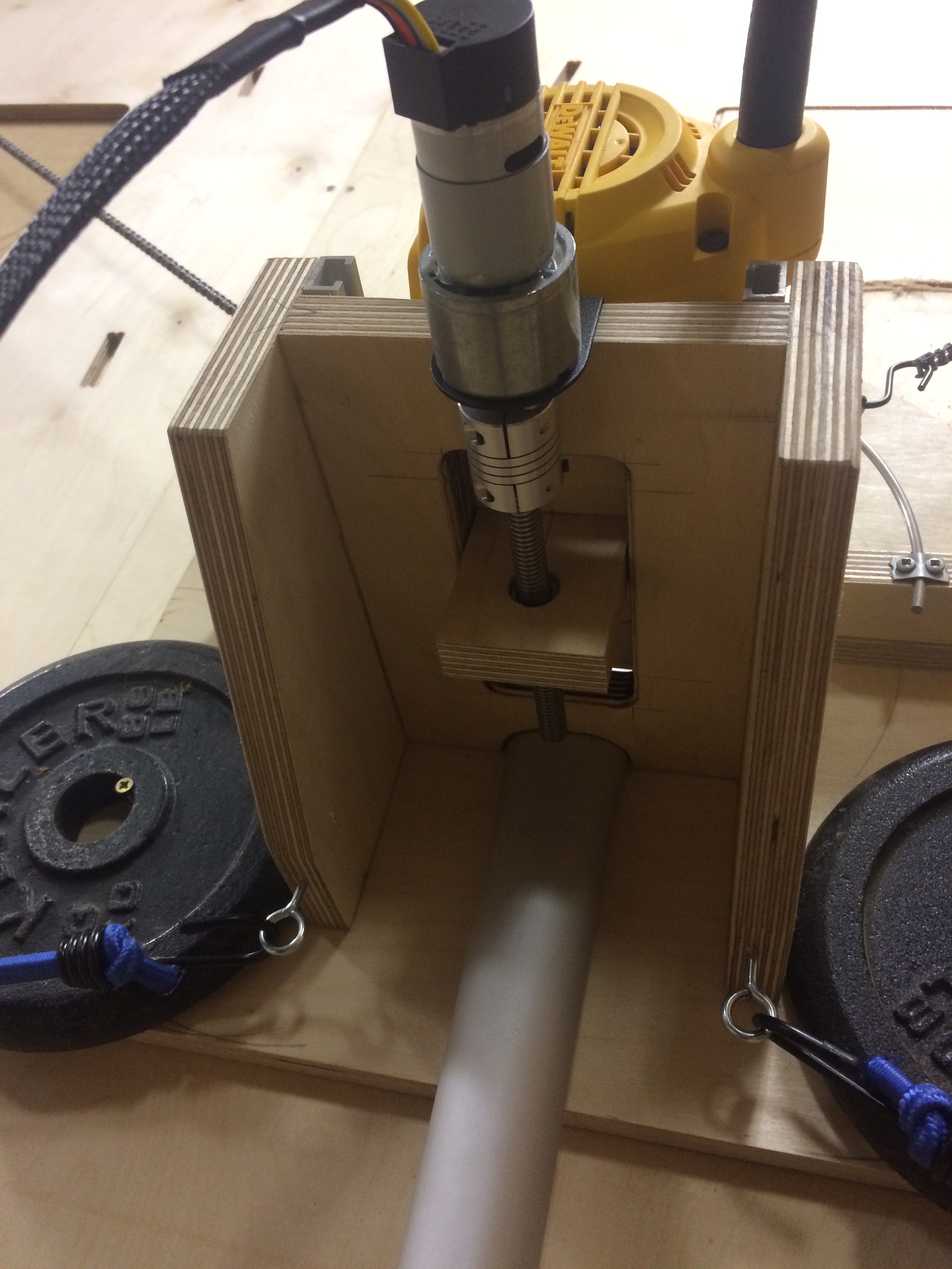

I made my sled with a ring system and a z-axis adjustment independent of the router used. Currently it holds a Dewalt but I think I’m Moving to a Kress 1050. The Kress can go as slow as 5000rpm which is suits the slow feed rates of the Maslow.

I love the pulley system, I sketched that type of thing out in early testing of Maslow but never did it. Very nice work. Love the z axis simplicity!!!
I like the counter-force bungee system. I’ve been wanting to test a similar setup (starting small scale) but since you have one made… how does it work for you? Do you find that the tension in the lower corners is helped enough (and not counter acted too much by the other bungee)?

I am curious as to how you formed your rod into a semicircle? I am looking to go this route but can’t come up with a good solution as to how to bend the rod in a accurate circle.
Thanks
It was actually a ring to start with, I just used part of it.
Looks good. More simplistic than my Z-axis design. What size threaded rod did you use?
Thanks, 8mm with 2mm per rotation pitch
Ok, I used a 1/4 inch 20tpi. I am finding it is too slow of a rotation. (sled will start moving to a new start point while still retracting) Next iteration will go with something similar.
Very nice. I have have the triangular linkage kit and my thinking about the ring linkage. Do you think it is an improvement over the triangular kit?

It’s unlikely to be significantly better.

Count me in as another person who is interested to see and hear about how the counter-force system works. I have designed a more complicated system for accomplishing the same thing, but I haven’t had the time to implement it. I would love to see any video you have of it working.
The more I look at this the more excited I am. This reminds me a lot of when @pillageTHENburn came up with the arm mounting design.
I have had a few instances where the router climbs in the direction of rotation out near the edges because most of the weight is being carried by the closer motor.
Based on the photos, I think you may have already done this, but this design could be done such that the counter-force increases as more chain is let out and decreases as chain is retracted. This would effectively change the angle of the gravity vector out near the edges because the force opposite the long chain would be very high and the force opposite the short chain would be low.
