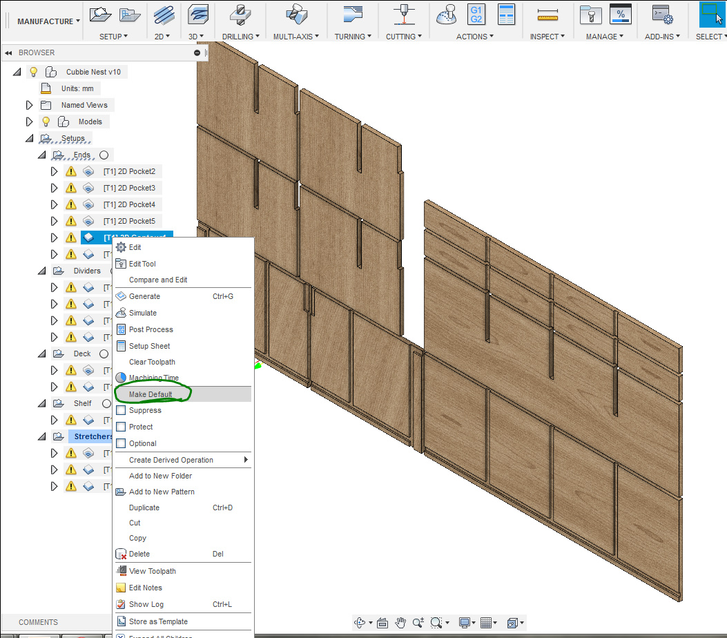

Are you trying to group all of these cut-outs onto one 2D contour operation? Fusion will try to intuit the order to cut each profile, but it doesn’t necessarily know to save the “outside” path for last. I program each profile as it’s own operation, that way I can order them as I like:
It may sound tedious, but it’s not really all that bad. You can set all your preferences for your tool path on your first operation, and then save it as “default” so the remaining profiles all get the same settings without you having to enter it for everything.
