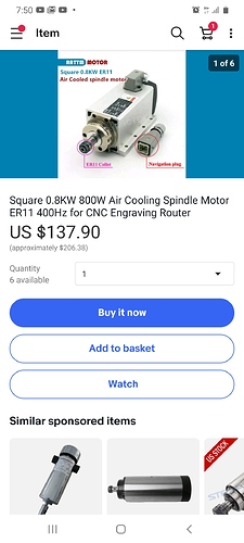

I did see these as well, integrated mounts which is nice
https://www.ebay.com/itm/373044367848

Haha! Yeah I know its way to big and powerful for what we need ive never heard my 700w makita struggle at all. I was more just showing the design with the integrated mounts which I think could be good for some people. I couldn’t find a 800w one but I just did now. $200nz for just a spindle though!
Don’t forget that some come without the ~3 phase power supply. My 500w runs of a 12V 10A normal DC and can be speed controlled with a 1-10V pwm module. There is lots of saving there in cash and space/wires.

Forgive my limited knowledge on these spindles, but do they need the inverter or could you run one off of a 3 phase supply? I’m guessing they must be lower voltage or something? I have 480v 32a 3 phase supply in my shed.
Just scrolled through the listing 220v 3 phase it seems
This kind needs the inverter, but the spindles come with or without (for those that have the VDF already). You can’t just connect your 3 phase.
They are bulky and the setting you can adjust on it do not justify a use on a Maslow.
Go for one that runs on a regular DC power.

most of the 500rpm or 800rpm spindles are driven by around a 40 or 50v power supply if I remember correctly. They look like 12v power supplies, but most are higher voltage. they are also typically generate electrical noise so don’t put near other electronics!
