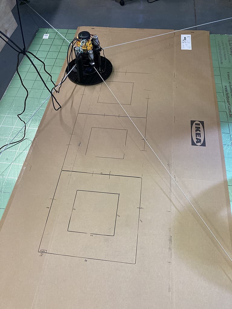

I ran some more calibrations today to see what would happen.
It is interesting to see the results plotted as graphs.
In the plots below the blue column is the manual measurements
The other colours (from red through to pale blue) are from earliest to most recent calibration
This looks like something mechanical is changing over time… possible belt stretch, possibly friction changing as parts wear in … or possibly temperature.
-Andrew
…. and its probably not temperature, no obvious correlation

Tommorow I’ll do some test plots with my marker pen fitting in the maslow and see how close to square I can get with the best of these values in the MaslowKinematics.
I think I’ll try a new technique to plot a grid of points, rather than drawing boxes as I suspect the marker pen might ’drag’ a little in its fitting and introduce a couple of mm of movement. A grid of points where I retract the pen while moving and then extend the pen to draw a dot should have it centred each time it marks a grid dot.
I just need to find another clean IKEA box!
-A
