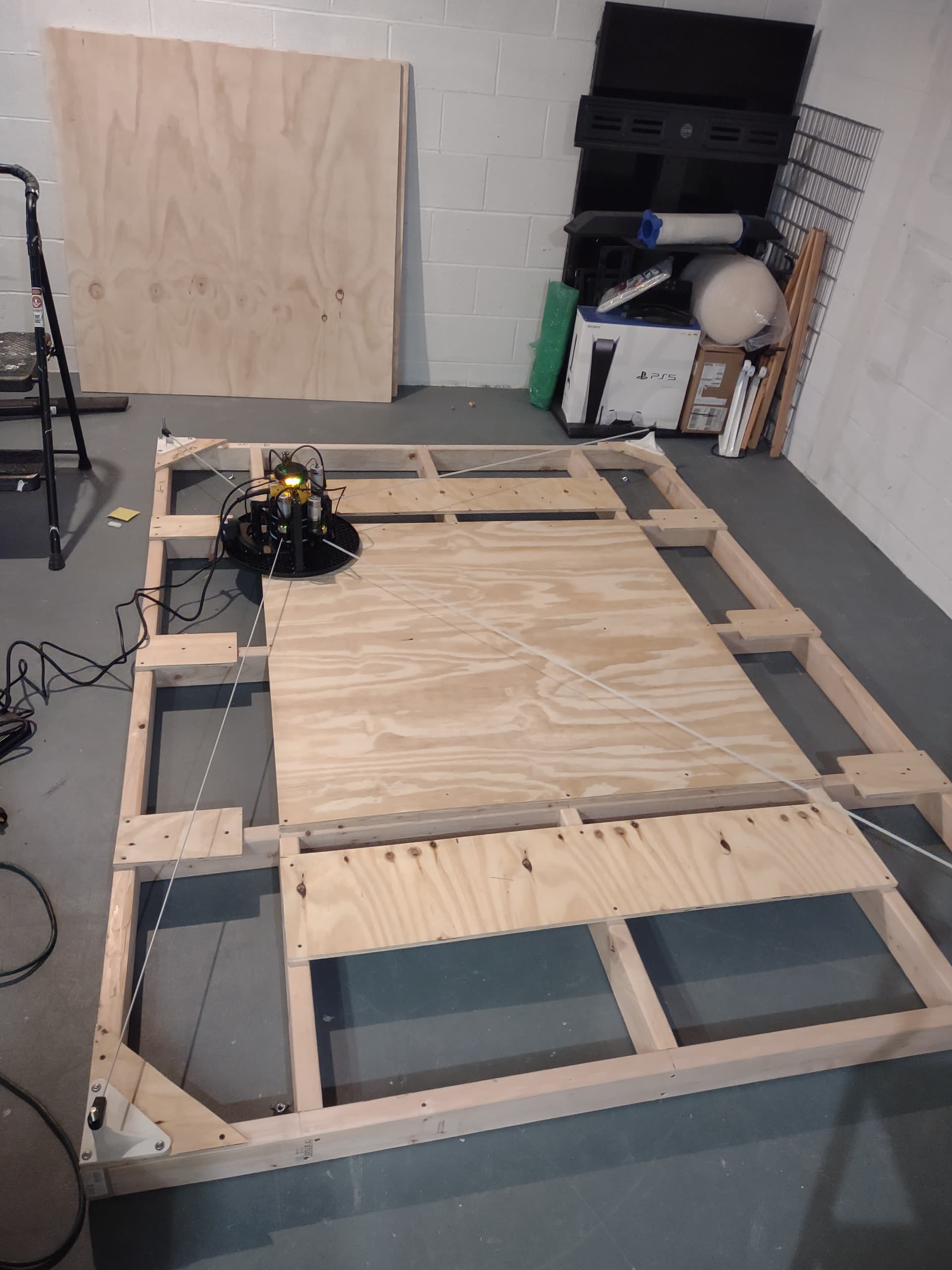

I’ve been battling my Maslow all day today to get it to calibrate. My frame is 72"x96" ( I can’t fit full 4x8 sheets into my basement so I am starting off with something that I can do down there using 4x4 sheet.)
I keep on getting high current typically on the pulling motors with the amperage going just north of 4000mA. I have rebuilt and greased the arms… twice . to make sure it wasn’t binding. I did have the same issues as others with the retraction but the new firmware update with the adjustments allowed me to get around this hurdle.
Now I am not sure about is why I am getting these spikes in current when there is less tension on the lines than when they are in retraction. It jumps around from motor to motor but mostly happens when the calibration starts and the only line that is tight is the lower left. Sometimes hitting calibration again allows it to continue on.
I’ve attached a picture of the build to show the last spot the Maslow failed. In this picture it was the top left motor that had high current. For reference the bottom left motor is in the upper left of the picture.
I have a theory for what is causing this and I am working on a long term fix.
I think that I might also have a quick fix that we can test right away.
I’m not sure why some people are seeing this and others aren’t but I am 100% sure that you didn’t do anything wrong and that it’s a bug.
How things should work
In the vertical orientation we use the top to belts to move around and the lower two belts are slack. Because of gravity we can rely on the top two belts always being under tension.
In the horizontal orientation we switch around which two belts are pulling and which two are slack. We rely on friction to ensure that the pulling belts are always under tension. This works great as long as the belts are retracting.
We should always have two belts that are tight and two belts that are slack at the end of the move.
What is going wrong
The issue is that the way we are doing moves right now is not coordinating the belts so that one belt often finishes retracting before the other. The belt that finishes first goes slack.
When we start to take a measurement by pulling the belt opposite the slack belt tight the slack belt gets “startled” by going tight suddenly and overcompensates sort of like if you go to pick up a soda can that you think is full and it’s actually empty and you end up picking it up faster than expected. This leads to the current spike.
How do we fix it
The long term solution is to synchronize the belts that are pulling so that they finish at the same time. I’m working on that right now.
The short term solution (that I would LOVE your feedback on since I haven’t actually gotten my machine to do this I might be totally wrong) is to give it a little extra tug at the end of each move so that the two belts which are pulling both end up tight.
Basically we want to pull gently in the opposite direction that it’s moving. That way it has something to pull against and one of the pulling belts won’t end up going slack.
Forgive me if I’ve described that badly or if I’ve totally misunderstood the issue.
The only thing that I’m 100% sure of is that it’s not your fault, it’s a bug, and I will fix it as soon as we can understand it.
In this case my theory is that the top left belt had some extra slack at the end of the move, so when the bottom right belt went taught it (the top left motor) overcompensated and created the error.

That would be tremendously helpful. If I can be sure if my theory is right or wrong it would make a huge difference in focusing on the right place to fix it.
That’s a really interesting and great idea. Yes, absolutely give that a go. Don’t forget to change the setting in the .yaml file to vertical first tho or it won’t work right.

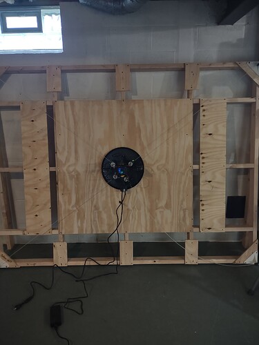

Frame successfully vertical and calibrated with 63 points. Seems to be working now. Haven’t ran a CAM file on it yet.
Out of curiosity is the bottom right cable supposed to be loose as seen in the picture. When I clicked “Take Slack” they all pulled but the sled was 2 inches to the right off center. I moved it to the left 2 inches and now the bottom right is slack.
Darn, with the correct locations for the anchor points in the configuration file we expect that all four belts will be taught the entire time. They should never be slack like that.
Now the question is what could cause that low of a fitness number.
Basically what that number means is that the calibration process was only able to locate the anchor points to within about ± one inch which is going to result in a lot of slack and or too much tension in the belts depending on which way it’s off.
In terms of what could cause that, I’m not sure. Potentially if one of the belts got caught on something and wasn’t able to get a good measurement or a lot of flex in the frame? Did anything weird happen during the calibration process?
