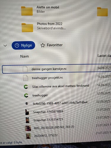

Error 66 when i press play
Ive finally assembled the machine, calibrated it, and everything seems fine. But when im trying to cut something ive made on carbide create, nothing happens when i hit play. And the message Error 66 appears. Cant find out what error 66 means. Please help!

where did you upload the file to the maslow?

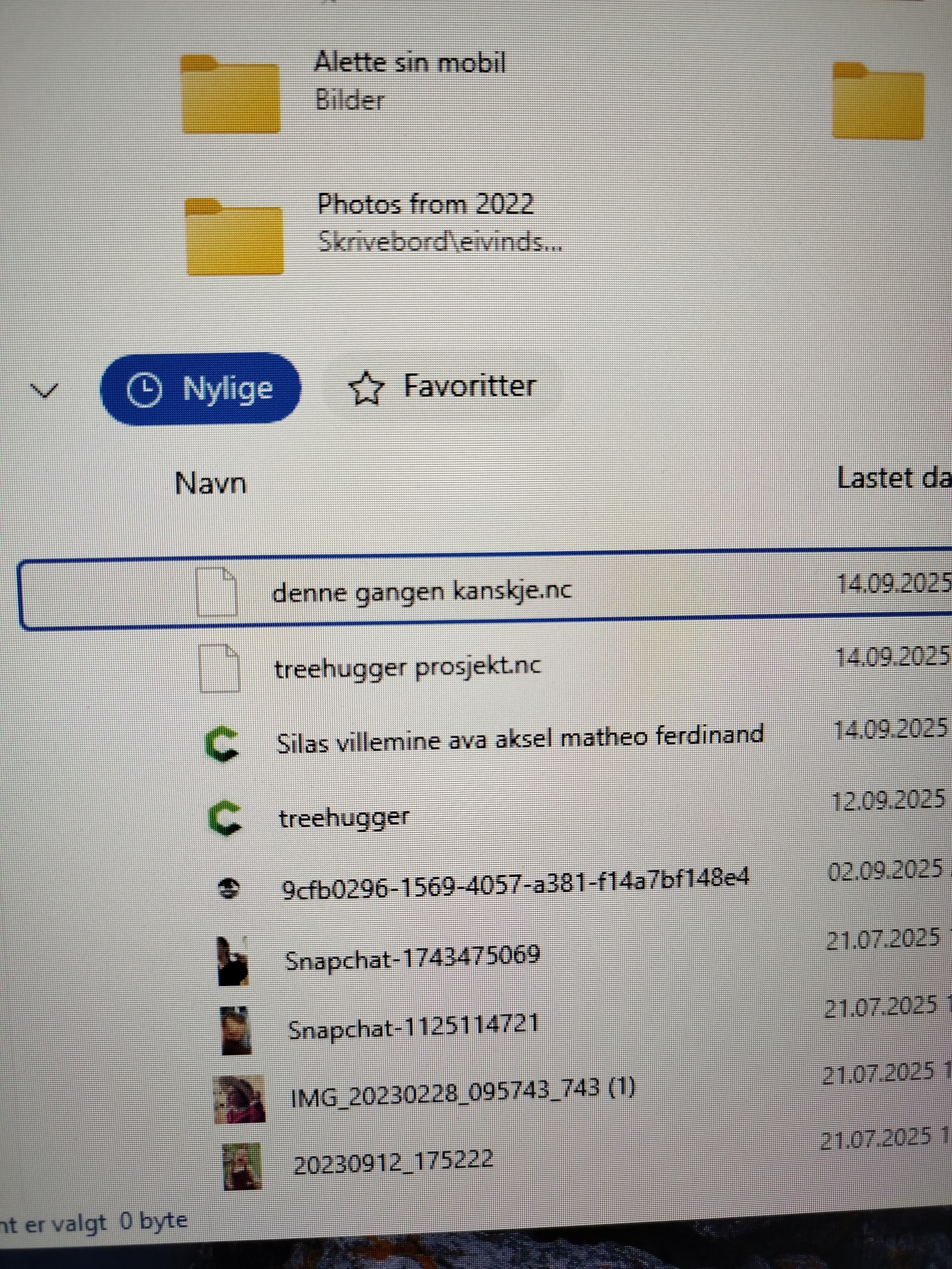

can you show us a screenshot that shows the file that’s selected?
Which version of Carbide Create? V6 creates normal gcode files. V7 creates a format that can only be used on their machines (I believe the paid V7 has an option to select grbl output).
i have the latest version of carbide create pro. When im saving the tool path, i get these options.
not sure i understand the question, but ive uploaded it from my computer. Its the one with the blue line
where do you see it in the maslow UI
