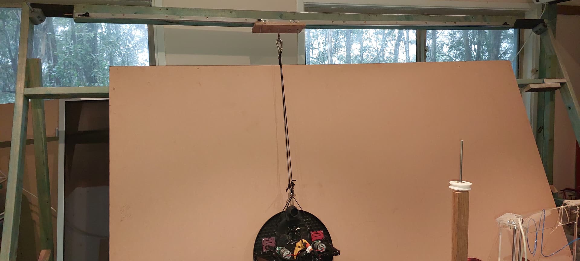

I was worried about exactly this happening after I broke a belt in the early version of software when the M4 decided to head off without restraint. Luckily I was using it on a horizontal surface at that stage so it didn’t damage itself, apart from the belt. Lately I had to move to a vertical set up so I have taken some precautions. I redesigned my frame and cut the internal vertical studs and put another crossbeam in lower. I then put a wardrobe track at the top and swung a counterweight to the maslow on the reverse side with just enough length to stop the M4 hitting the floor if 1 of the upper belts break. It also reduces the effect of gravity on the sled.
Attached are some photos
