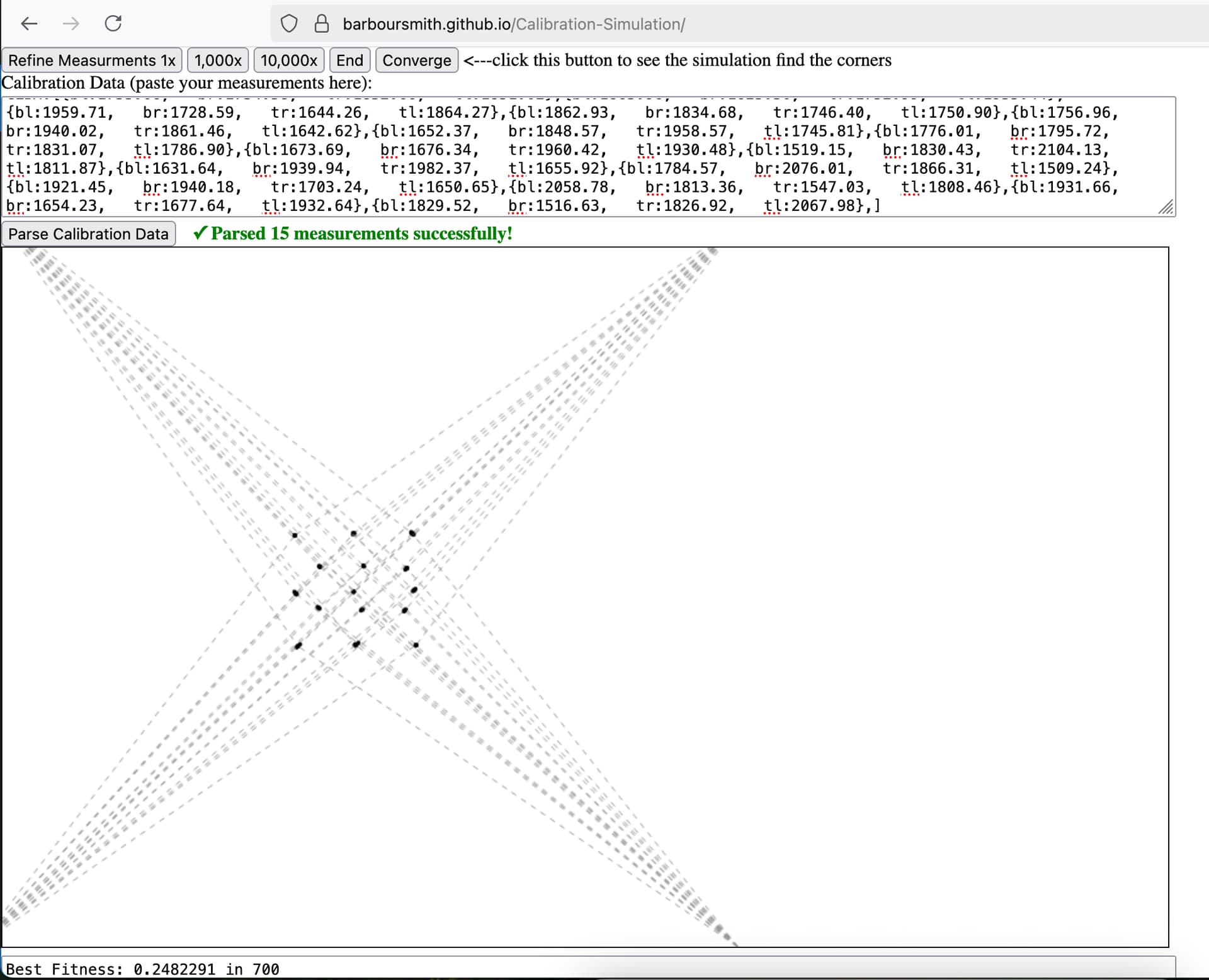

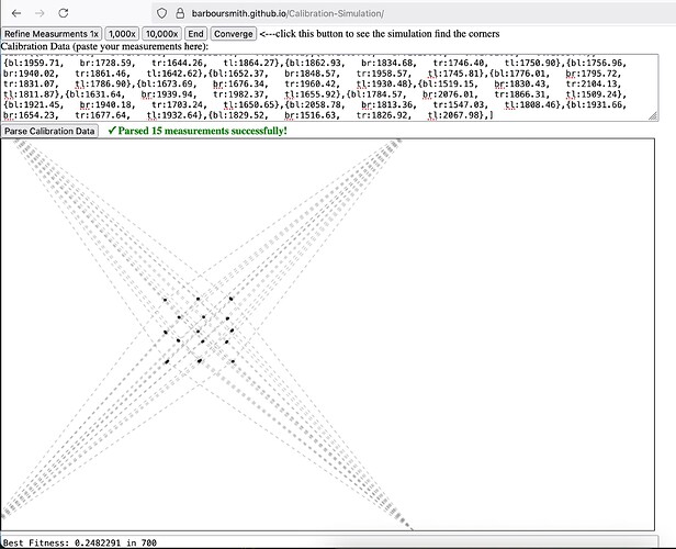

FITNESS being uncooperative
I installed my new gear that arrived yesterday. I have gotten further that I’ve ever gotten with the calibration process, but fitness is still being uncooperative!
Maslow-serial (1).log (34.1 KB)
Attached is the log
I¢ve ever gotten with the calibration process, but fitness is still being
uncooperative!
I was fighting bad fitness on a machine today and found that I had the incorrect
Z offsets in place, I was off by ~20mm and that took me from a fitness of ~0.3
to a fitness of ~2.0
I don’t think I’ve even touched my z settings. Is that part of the setup process?
Big_Spark wrote:
I don¢t think I¢ve even touched my z settings. Is that part of the setup
process?
it hasn’t been, but we are seeing indications that it needs to be.

Looking at the log I’m not seeing anything catastrophically wrong, it just seems like the measurements aren’t quite good enough to find good anchor point locations.
Did it seem like all of the belts were tight at each measurement? Did anything at all seem off during the measurement process?
The only thing I noticed was the sled would lift from the table. Yes, the belts stayed tight.
My frame is a variation of the original Maslow frame. Think I will readjust my anchor points based on D. Lang notes above.
try reducing the current limits, find the lowest current that reliably retracts
the belts (and when you do a calibration, make sure the belts pull tight at
every point)
