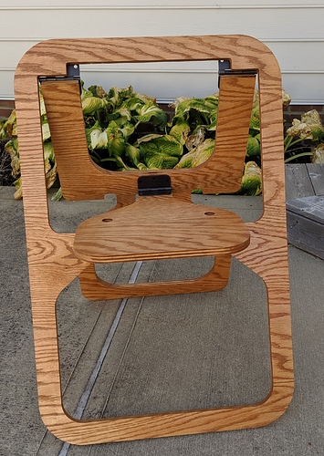

I got it cut as well…and am pretty happy with the results.
Though i am not entirely certain about the stability of the chair, perhaps i could add cross-braces at the bottom to make it more solid. ANy suggestions?
@tempQ
The stain color with the black hinges looks awesome!
Do you mean that the chair can easily tip over on its side? You could square off the legs that sit on the ground like this:
If you are talking about adding braces (more material), then it wouldn’t necessarily be “fold flat” :wink:
i am not concerned about it tipping over side to side - its pretty stable that way. However, once you sit on it, the back legs have a tendency to shift. If i put a removable cross brace at the bottom, it just makes the base more stable.
I am just speculating though :wink: it’s a pretty fun project to cut
