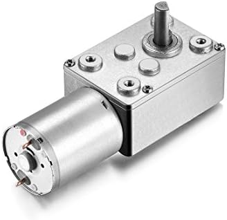

I ordered these from amazon thinking I had the correct gear box but was going to switch out the motor for one with an encoder. Should have checked the measurements as what I got was a very small motor and gearbox. Can anyone post the dimensions of the gear box/motor that comes with the kit? It appears that item 232236292051 is probably the same small gear box and motor with integrated encoder.
that gearbox has the screw holes at 18x33mm, the maslow motor has them at
~27x40mm
the motor is a lot bigger (the one you link to is 25mm diax31mm long) at ~37mm
dia and 58mm long (75mm including the encoder)
That is the concern with this ebay motor with encoder as no sizes are given. http://www.ebay.com/itm/232236292051?var=531453441964 I think it is the smaller gear box/motor with an encoder added.
I bought two of these http://www.ebay.com/itm/Hightorque-Turbo-worm-Geared-motorGW370-DC12V6RPM-motor-with-encoder/142034119941?ssPageName=STRK%3AMEBIDX%3AIT&_trksid=p2060353.m1438.l2649 I went with these because they have a force of 30kg-cm working and a stall force of 150kg-cm. the item discription has all the spec and mounting sizes with a 972 gear ratio and 11ppr for 10692 steps. it is a 1/4 of the speed but shoud get the job done.

Not to rain on your parade (and might still work) but if ratio is 972 your total is =972 x 11 x 4 (quadrature) = 42,768 ppr. I do not know if the arduino can handle those pulses. That is why it is so tricky trying to aim for the stock motor at ~8000 pot.
Over and Out
A counter/divider ic for each quadrature line could scale that down to a reasonable rate. :wink: :sunny:
Great idea! Use them to scale it down. How specifically would that be done?
Wouldn’t want to deprive you of the fun part :grinning_face_with_smiling_eyes:!
Are you sure division is needed?
At this point I have no clue whether they need to be divided. I will know more after I get a new mega today (last clone fried). I will be testing some small but decent value motors with the maslow board …the total on these is like 14,000 per revolution. We shall see if arduino keeps up. I just hope I did not get a bad maslow board as last test did not work and determined bad mega…
