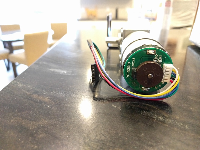

IMG_20171202_112819IMG_20171202_112858
@thuber , with your small motors, did you have to modify any of the code? Or did they just wire up the same and work?
Dfsrobots,
They were direct replacements. Just be sure to get the wires right for the connection. I was messing up in the beginning by having the motor signal on the wrong lines. If using the real maslow board, you will need to come up with solution for cables. The one that comes with tiny motors are tiny, lol. I made cables, which also keep the encoder lines away from the motor power lines. I just did that to help in any way the signal, because it has over 14,000 pulses per revolution.

I sourced these motors https://www.aliexpress.com/item/Precision-GW4058-31ZY-Turbine-Worm-DC-gear-motor-Magnetic-Bipolar-hall-encoder-Dual-output-shaft-motor/32798101510.html with a 1:280 ratio. The specs are here for the 12V:
Everything seems to be okay with these, but as mentioned above by people more knowledgeable than I, the stall current is a problem.
This will explain why I’ve not managed to get them working with the Maslow H-Bridge shield. My wiring harness wasn’t very attractive, and may need another look, but I’m pretty sure the wiring isn’t the issue.
Is there a quick fix to the stall amperage, such as throwing in a resistor or such like, or am I dreaming? I think the latter! I may buy another H-Bridge to get these motors up and running in the future, but I currently await the proper motors as I’m tired of failure this week!

Those motors should work because (unless told different) the 2.3 amp stall is ok on stock controller. That is if I read that correctly.
The reason they did not work (if you just plugged them in) THE ENCODER WIRING IS DIFFERENT. I could not see the entire ad that showed the wiring layout but the part I saw was wrong!
I will post the correct pinout for you in a minute when home to double check. I know for a fact the board is set up different. This is why you got zero movement. Easy fix. Check back in 30 mins!

Your hookup. This was where I messed up because I only have 10 min time slots to do this stuff and casually looked at the functional placement schematic when making cables and switched the dc power with the ppr lines, doh. After Bar showed me that the schematic was not wrong but if use to reading how I did and not tracing (my fault), you would get them mixed up.
So, if going off the partial picture I saw of the encoder wiring for yours you can see it is not the same as the board.
So the great part is that all cables that have connections like these that I have seen, are easy to rearrange. Just use a pin or tool to push on the showing metal and lift the plastic gently right behind it as you pull out the wire. Then put back in the correct ones and they will snap. Hopefully having voltage on the encoder meant for the motor did not fry encoder but I do doubt it. If so tell me cause I was able to replace a hall sensor no problem…but can get touchy.
The pinout for your board (Maslow) is as follows:
From the top looking down and power plug to the right:
1.m
2.m
3.g. note 3 and 4 might be switched (Not in front of me to verfy)
4.3.3-5v
5.en in
6.en in
BUT I KNOW FOR A FACT THAT BOTH MOTOR PINS ARE AT THE TOP OF THE FEMALE PLUG ON BOARD.
BOTH OF THE ENCODERS ARE ON THE 2 BOTTOM PINS AND THE GROUND AND V FOR ENCODERS ARE IN THE MIDDLE.
If you have any questions, feel free to ask. I do not see why you could not get them set up with what you have assuming these are 2.4 amp peak motors…if higher than that…no, but you can get a cheap 5-7 amp board no problem.
Best of luck.
If you need the actual mapping just ask, I am not in front of them and would need to see your encoder. My brain is scrambled a bit so not remembering specific plus and minus. But fact is the pinout I gave is correct. Actually back when I first set it up and was shown my error, many others chimed in and said they would have done the same thing i did based on the posted schematic (Not placement schematic …but initially read it as one)
