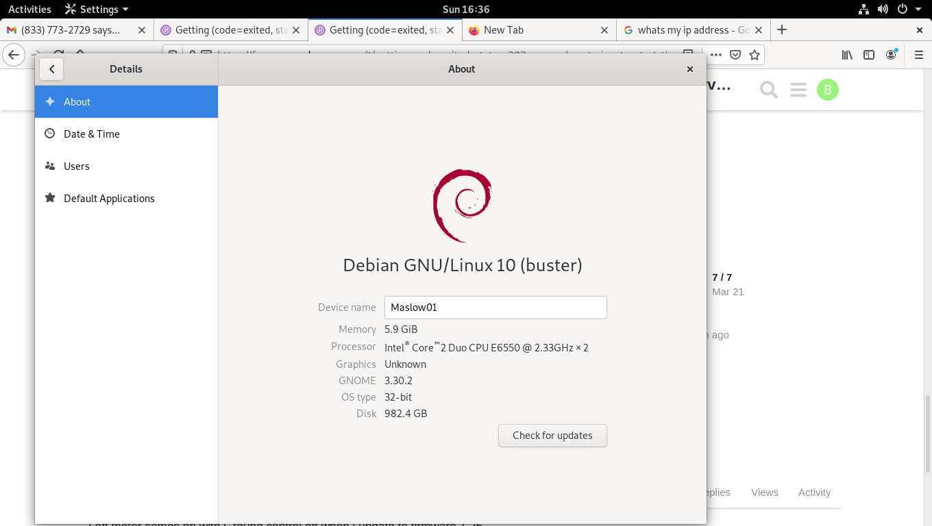

I am attempting to set up a dedicated PC to run WebControl using a fresh install of Debian Linux 10 (buster) 32bit OS

I was finally able to work with the server this is what I’m getting…
b0rgn1ne@Maslow01:~$ cd \webcontrol
b0rgn1ne@Maslow01:~/webcontrol$ webcontrol
bash: webcontrol: command not found
Typing LS confirms that the “webcontrol” file exists
the command is “./webcontrol” without quotes.
got the following…
b0rgn1ne@Maslow01:~ cd webcontrol b0rgn1ne@Maslow01:~/webcontrol ./webcontrol

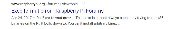

bash: ./webcontrol: cannot execute binary file: Exec format error
are you using the raspberry pi version or the windows version? Google:
So, I can use an"RPi" package on a X86 based Linux system?
Actually, no. You can only use the rpi package on an rpi and the x86 on an x86 pc. You need the linux version.
