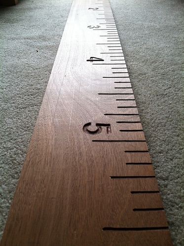

I am trying to use on shape to create this file. I am not getting anywhere. The idea is a 10 inch wide board at 6 ft long. The starting point would be 6 inches and end at 6ft 6 inches. The 1,2,4,5,7,8,10,11 inch marker would be short. The 3,9 inch marker would be longer. The 6,12 inch marker would be the longest. This would go for every foot. Every foot would be labeled with its corresponding number. It should be an easy draw one foot and duplicate the rest. I may try and do it on sketch up unless you have suggestions. This also would be a great file to add to the first 10. (All the wives would love this project.)

A formal type font that would be easy for the standard bit to cut.
Take a look at this file. I think it reflects what you were trying to do. I put some toolpaths in to make sure it looked right, but didn’t do a profile around the whole thing.
https://www.evernote.com/shard/s276/sh/9d97bb73-7a96-4368-9386-c28af016aee4/b6b9d4c983180244523e1badebc10239
That’s exactly what I’m trying to do.
Did you make that our did you find it? What is a good program to use on android?
I made that using visio… its a microsoft product (expensive as well) that I often use for work. Its great for making diagrams to include in reports.

I have tried all the cad programs out there. I went back to sketchup and was easy to get this finished. I have the svg file and the original sketchup file. Where can I upload for you guys to look over it and get it ready to cut? We can add it to the 10 free files list.
