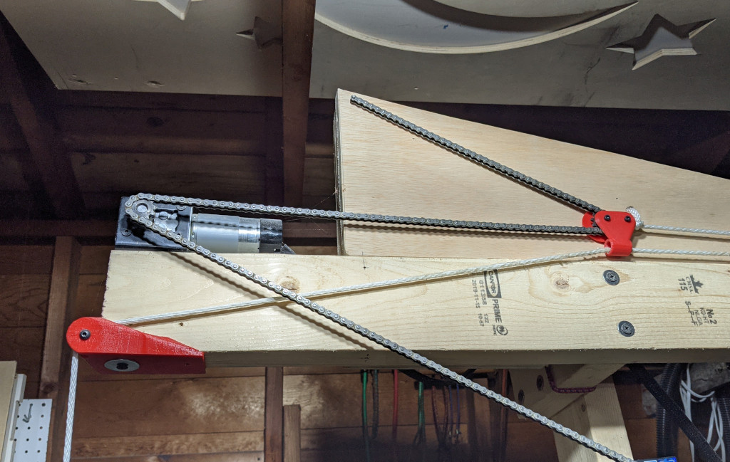

Improved chain tensioning for top beam configuration
Nothing too crazy here, I haven’t actually cut anything yet (Arduino connection issues) but this seems to keep decent tension on the chain. I have 4 18oz bottles of water (~4.7lbs) on each chain.
Hopefully I’ll get it running tonight and see if my setup works well.

Adding my build to the list. This reuses the bearing pulleys used by the bungee plus some 3D printed parts. The kitty ears on top aren’t strictly necessary but it does greatly the chain rubbing on the rope.
I added a guide for the other rope to my tension sled. This prevents the rope from tangling with the chain and sprocket. Everything stays in order even when moving across the entire X axis. The links above have been updated with the new files.
So looking to update my rig with a pulley/counterweight system similar to what @Snapperhead posted he did to his. Looking at Lowes, they have these (in both steel and nylon) https://www.lowes.com/pd/Prime-Line-2-Pack-1-in-Steel-Sliding-Screen-Door-Roller/3043872. I’m just wondering on anyone’s thoughts on if they would work for the top pulleys (I plan on keeping the rollers I have with the bungee system as they are currently mounted in the position that @Snapperhead has on his. Thanks in advance for the assistance!
this works better, it fits the chain very nicely
as for the other end, you can get fancy with multiple pullies, but a simple
electrical sweep of plastic works well
see the pictures in this thread

@dlang That’s an idea as well. I was looking to go with the weights to the back in the center, and that sweep can work like that as well. I’ll have to ponder some more as to what I’m going to do. I have been contemplating mounting my frame to the wall, so this is an idea that I can keep in mind for that.
Thanks!
with a 10’ top beam it gets a bit crowded in the middle, with 12’ top beam you
would have pleanty of room.
I copied the dlang solution and it works great!!! (use it on a 12’ beam).
