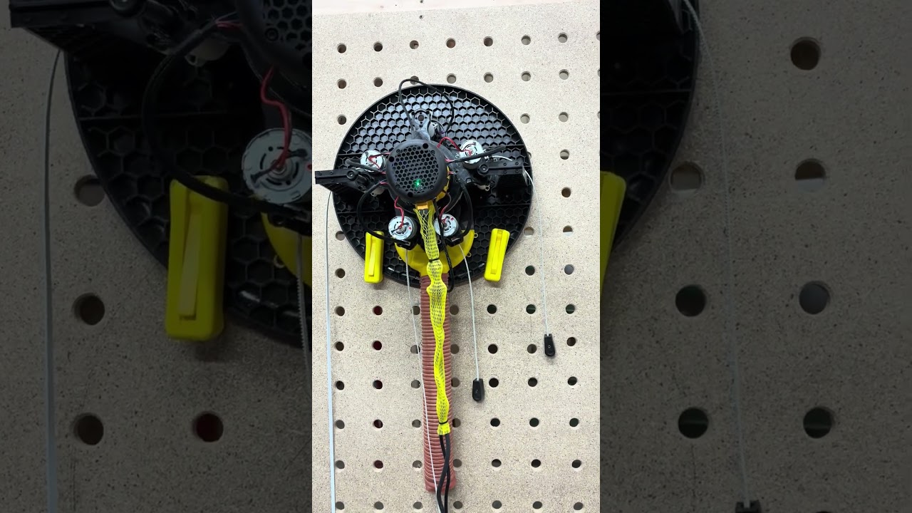

That was a temporary fix. I replaced the belt ends and they are now installed inside the printed frog mouths.
Can you take a photo, trying to visualise you setup
Does it look like I have one spool that is not measuring lengths properly?
I’ll have to take a photo when i get home, currently at work. Is there specific parts of the setup you would like photo’s of?

The anchors are within >1/4 of square. I’ll try manually entering the numbers tonight. Her are some photos I found on my phone.

looking at those, it looks like the anchors will raise the belt ends up a bit,
so you would want to enter a negative wasteboard thickness (since the bottom of
the sled is below where the anchors are) by the thickness of the base of the
printed parts.

Here are the photos of the anchor point in relation to the spoil board and the measurements for the frame measured from center to center in all directions. My son is uploading the video to youtube and I will post the link when he is done.
