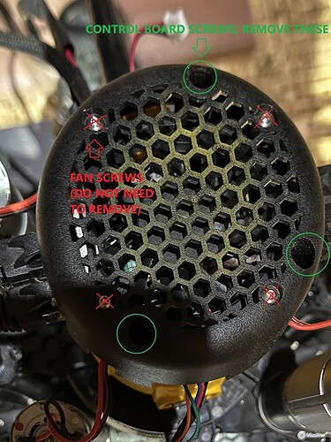

  2. Remove the three screws on the M4 control board cover.

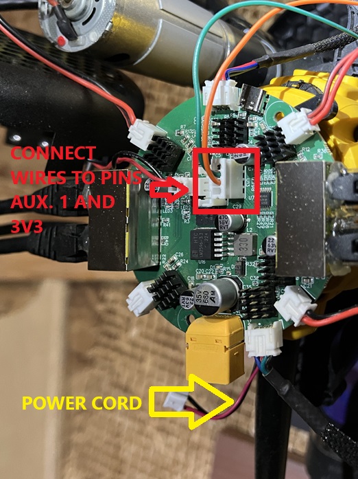

  3. Locate the connector on the control board with your auxiliary connections (according to @Bar, only two auxiliary connections are not being used for essential machine functions, we will use Auxiliary 1 which is GPIO pin 48 on the control board). There are 2 identical connectors right next to each other, so be sure you have the correct connector. With the power cord pointing downwards, you are looking for the connector on the right.
  4. Take 2 lengths of wire (length depends on how you are setting things up but I used ~6"). These wires will be used to connect to the 2 control board pins. I only used ~6 inches of wires so that I could disconnect and store the rest of the z-probe while keeping the wires connected to the control board permanently connected to the board (since my wires hang out the side of the control board, I didn’t want them too long that they would get in the way of anything). A disconnect is highly recommended to avoid having to constantly remove the control board cover every time you go to use your probe.
  5. Attach some sort of connector to the ends of the 2 wires that will connect/disconnect from the rest of the z-probe. This is not strictly essential and you could just touch exposed ends of the wires together to make a connection, but having exposed wires just hanging out is not a good idea for a ton of reasons. Note: If you use a connector (as I did), it doesn’t matter where the wires are positioned in the connector as long as they match up with the wires coming in. That being said, the other end of these wires (step 6) must be connected to the correct pins).
  6. Connect a wire to the Aux. 1 pin on the Control board connector (see picture under step 3 for pin layout) and another wire to the 3v3 pin on the connector (3v3 is a 3.3 volt powered pin). I used a 4-pin female JST-HX connector (and some wire from a breadboard kit) in order to match the connector on the board. You could instead solder the connections (if so be careful not to accidentally jump any of the connections together) or use some other means of making a connection to each pin that won’t come loose after using the machine.
    WARNING! However, you make the connections, be careful not to permanently jump the pins to each other (especially, the 3v3 pin to the Ground pin). If you jump the 3V3 and the Ground pin, it will cause the board to reboot (though it didn’t seem to do any permanent damage to my board when I accidentally did it).

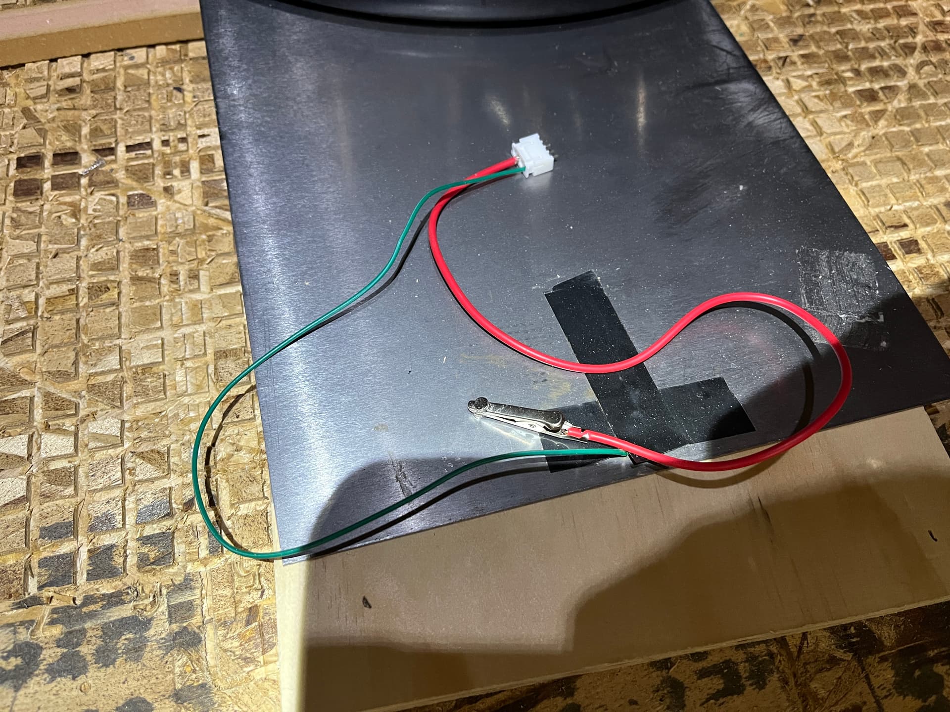

  8. Take 2 additional wires, and put a connector on one end to connect with the wires coming out of the control board. I used a JST-HX connector so that the wires can easily connect and disconnect with the wires going to the control board. You likely want a bit of extra length in these wires (~8"-12" or more depending on your build) since these will be going to the router bit and to the metal plate then connecting up with the connector that goes to the control board. You can use alligator clips for one or both of these wires. I recommend using at least one alligator clip for the wires going to the router bit/collet. To make the connection to the router bit even easier, I glued a couple small magnets to the end of an alligator clip (the magnets have a metal coating so still conductive). (Note, it doesn’t really matter which of the 2 wires connects with which of the wires in the connector going to the control board as long as one wire connects with each (i.e., if the circuit runs from the bit to the wire plate then to the control board or from the metal plate to the router bit then up to the control board–exact same results).)
  9. Connect one of the wires to the metal plate. For now, I just stripped back about an inch of wires and used some electrical tape to secure the wires to the metal plate. You could solder the wire to the plate, install some sort of screw to secure it, use a magnet, use an alligator clip, or however you want to do it. The biggest thing is to make sure that, however you connect it to the plate, the bottom of the plate stays flat and is not raised above the work surface.
With that, you are done building the z-probe. The next steps are for configuring the M4 to recognize the z-probe.

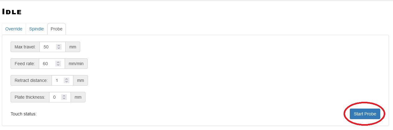

  9. Go to the “Preferences” tab in the upper-right corner on maslow.local and click to enable the probe settings.
  10. Go to FluidNC controller tab.
  11. Go down to the Probe options.
  12. Adjust the Probe settings to your liking. These can also be set in the Preferences before (see step 9). See the photo below for descriptions of the settings.
  13. Start your probe. Click the Start Probe button to start the probing. (If clicking “Start Probe” outputs a "G38.6 "command in the Commands info box below the probe settings, update the machine to the latest firmware, and try again.) (Note: Before probing, you can enter “?” into the Commands info box to show the current positioning of the machine and the status of any switches. If the probe is working and a circuit is currently active, you will see “PN: p” in the Commands info box along with the machine’s position. In FluidNC, “PN” means there is currently a switch in the active/connected state, and the “p” after “PN:” is specifically for a probe-type switch. So, “PN:p” is FluidNC saying that it is currently reading a switch as active and that switch is a probe. If you’ve built and configured everything, you can test your probe by touching the bit probe-wire to the metal plate (creating a circuit). If everything is working, you should now see “PN: p” in the Commands box when the connection is made, and, if you break the connection, PN:p should go away.)
  14. The machine will lower (no farther down than the “Z-” number/distance). If the bit makes contact and the probe triggers then the machine will stop there, set the machine’s z-home position where contact was made (you do not need to manually tell the machine to set the z-home position), and raises back up the “Retract distance” (see Step 12). Based on my own testing, the z-home position set automatically by the machine after clicking Start Probe is accurate to within 0.1mm (I was testing in 0.1mm increments, so that is a lower bound of its accuracy and it very well may be even more accurate than that).

I’ve updated the instructions here to reflect that the “Start Probe” button is now working as of firmware V0.85.
I highly recommend using the Start Probe button to activate your z-probe. Not only does it trigger the probing without having to type a custom command into the Commands info box, but it also automatically saves the correct z-home position for you and raises the bit back up to a safe distance after contact (this safety distance is based on the “Retract distance” that you set in the probe setting; I like 10-20mm of safety clearance personally).
