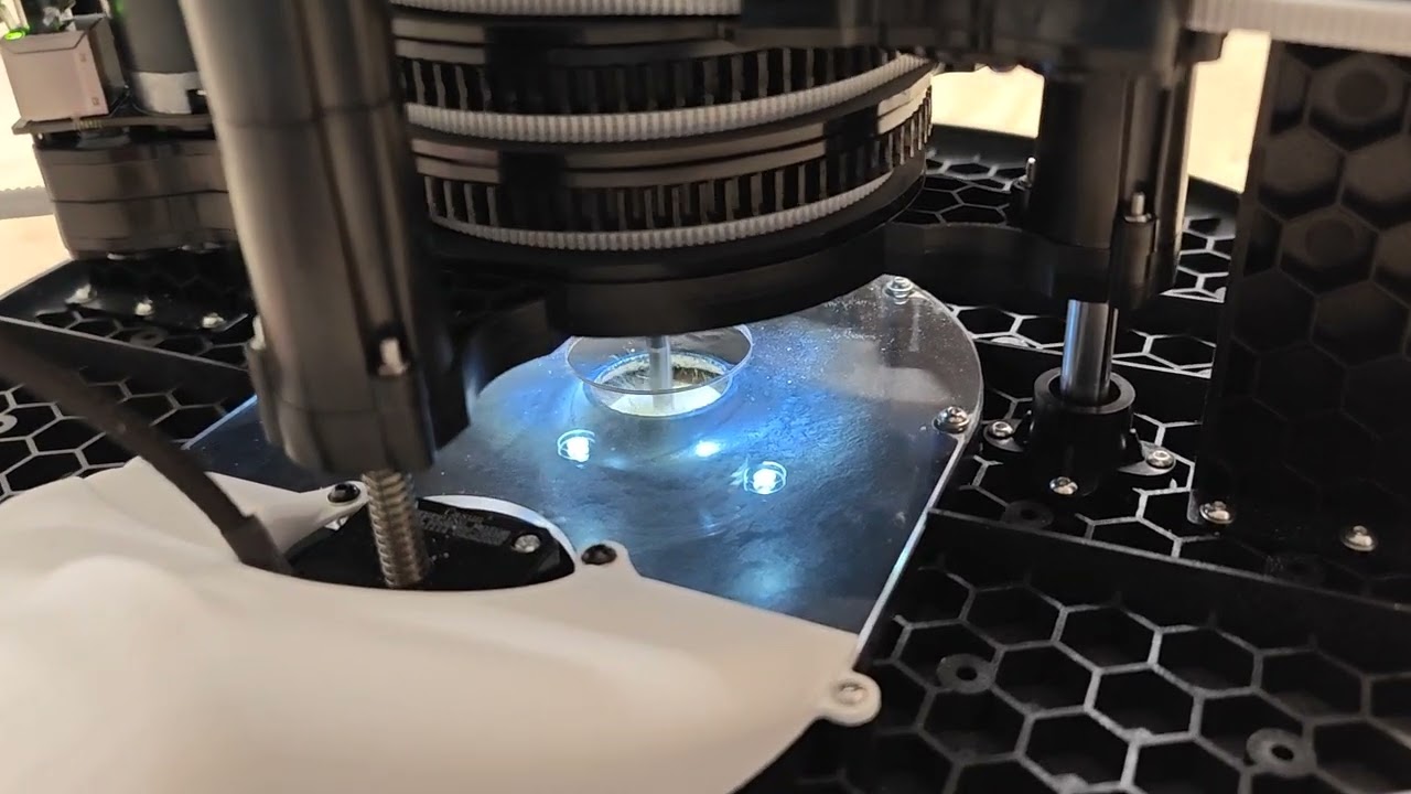

Hi, I run today evening the calibration on the new firmware 0.70. I got really nice values and a fitness I remember correctly close to 0.9 (I think 0.88) on a 7x7 grid with 1260 x 550 mm. The values also matched really nice to my measured values.
After calibration I cut another Maslow Logo and a circle at a feedrate of 1500mm/min. The maslow logo took about 5 minutes. Very very quick compared to 3D-printing! I show you a picture! What feed rate is recommended?
Is that like one pass? I’m doing a whole sheet at the moment, but went with 40in/min and 0.125" step down and the estimate was around 2.5-3 hrs.
Looking good! I usually do 1800mm/min, but I’m no expert ![]()
Two passes with 6mm depth in 9mm plywood. The tabs were 4mm high so in fact only 1mm in the workpiece. The router was set at the lowest speed. This time there were more chips then only dust. It is really important to cut fast enough that you lift up chips and not only rub the bit against the wood.
