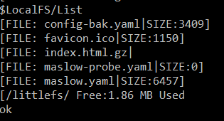

After updating to 1.11, I had trouble with my maslow.yaml file and blew it away with a full-install. I attached to the built-in wifi and was able to calibrate 3x3 500x500. When I ran the file I’ve been testing with it didn’t appear to wiggle. I didn’t have the motor currents page to view though so went to the FluidCNC and changed the setting. It didn’t appear to save correctly and upon reloading the web gui I was shown garbled text (likely the browser interpreting binary). After power cycling the Maslow I was sent to a capture portal error page that just cycles.
I loaded up fluidterm and tried to reupload index.html.gz and maslow.yaml manually, but get a failure mid upload. Ignore the file name, just trying to grab a representative screenshot.
I tried all combinations of install-fs, erase, and full install, but there seems to be something terribly wrong with the non-volatile storage. I am able to revert to 1.10 and have the same error.
You can see the result of the failed yaml upload. If I try to just CTRL-U a new maslow.yaml or index.html.gz I get the same error on upload and then it fails to show a file size in the listing.
I would recommend just running the Full-Install.bat again which should overwrite everything.
The “Error ESP_ERR_NVS_NOT_FOUND” isn’t a big deal. That just means that the machine couldn’t find a saved value for the z-axis position but that’s to be expected after a fresh install.
