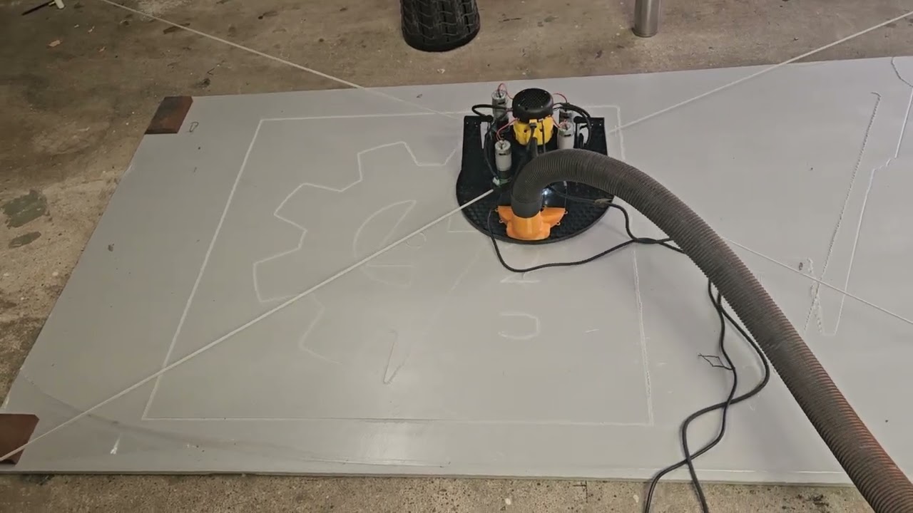

There’s a tiny bobble/missed area on the top center (left in this picture), but nothing else jumps out. Needs some quality time with the giant calipers.

How big is your frame? You might be pushing the edges of where the good working area is. Check out this simulator that can help to show where the machine will be most accurate:
That wavy pattern is for sure the calibration being a bit off and the motors fighting each-other, but that could be the result of something funky in the calibration, or it could be just pushing the limits of how big of a work area it has.
Yeah, the salmon color lines up with the squiggly parts. Argh. At least I know what’s going on!
Looks like I should consider re-doing the anchors and change my 2443.2, 3679.2 to more like 3100, 3679mm. It won’t fix the corners but it will improve the middle hourglass thing.

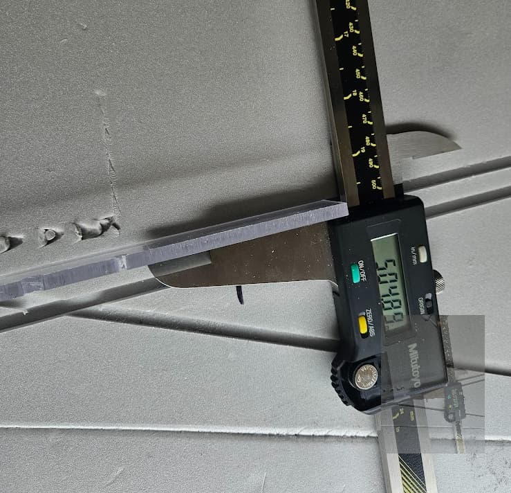

Here’s a good trick to avoid smooshing your styrofoam when measuring: put in a strip of plastic!
If its not 1/4" thick you will need to do some math.

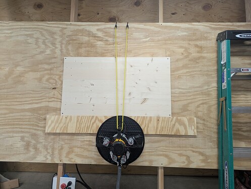

I started trying to cut this past weekend and also experienced a wavy pattern. Mine was near the center of the spoil board and not physically far from where the machine had been correctly cutting. The machine was moving up and diagonally up when it was wiggling. The opposite end of the piece moving vertically down was straight. Should I be re-running calibration too? I’m on firmware 1.0.7.
Workpiece relative to spoil board
Detail of wavy cuts
what feed rate are you sing, it may be that you need to slow down (diagonal cuts
are where the machine is the slowest)
were all the belts still tight? I’d bet that some of them we slack.

You would be well served with some blocks outside of your part to prevent the sled from tipping near the edges!
My feed rate in Fusion360 is set to 508 mm/min. To the best of my recollection, the belts were tight.
Roger on the blocks. That’s why I added the piece below what I was cutting. I didn’t notice any tipping on the sides.
that should be slow enough, but try slowing it down, and get a video of it
cutting in the problem area
